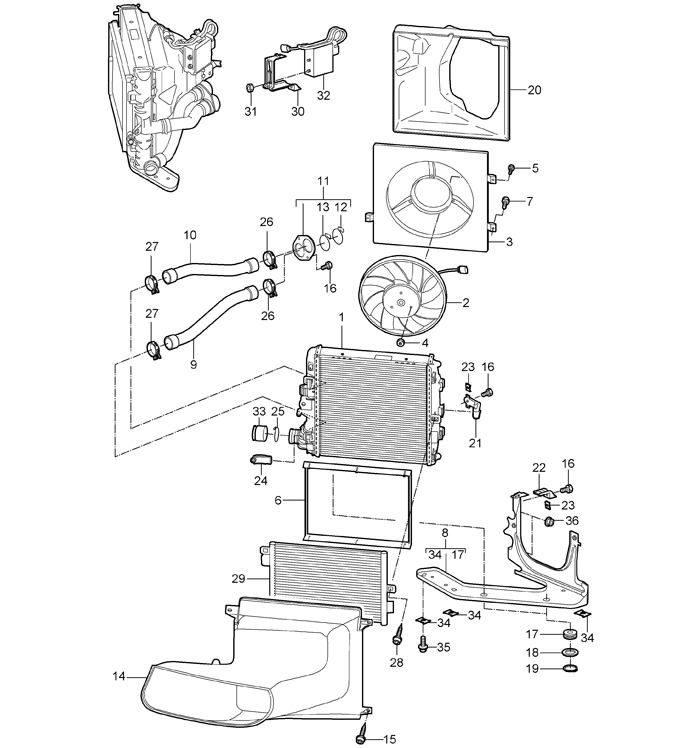

If you look at the exploded parts diagram above, you will see that the fan is mounted into a shroud, which is then held in by a couple of fasteners.  You do not need to drain and remove the radiators, or the AC heat exchangers, they remain in the car.
