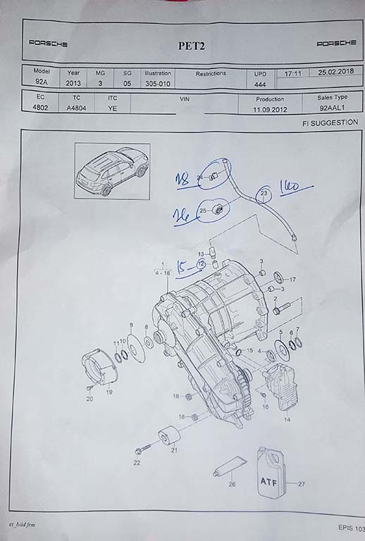

Also got ATF (approx. $57 for 0.85 Ltr) from Porsche will get it changed tomorrow or day after.
Anyone knows DIY transfer case Breather tube change. I got it from Porsche but need help to put it on transfer case post fluid change.
Keeping my fingers crossed. Else going for replacement and tank my bank account :helpsmilie:
2
I'd be very interested if you can install the modified breather tube. As far as I can see - the breather is on the very top of the transfer case, and only really accessible with the case removed. And the piping for the vent going up into the engine compartment - it also appears to need the transfer case removed to install.

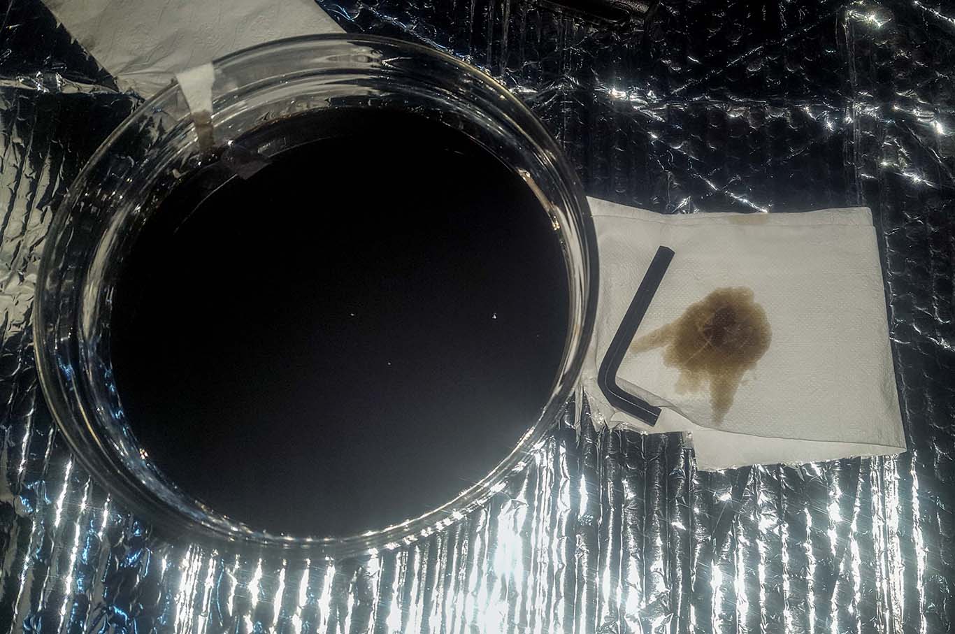

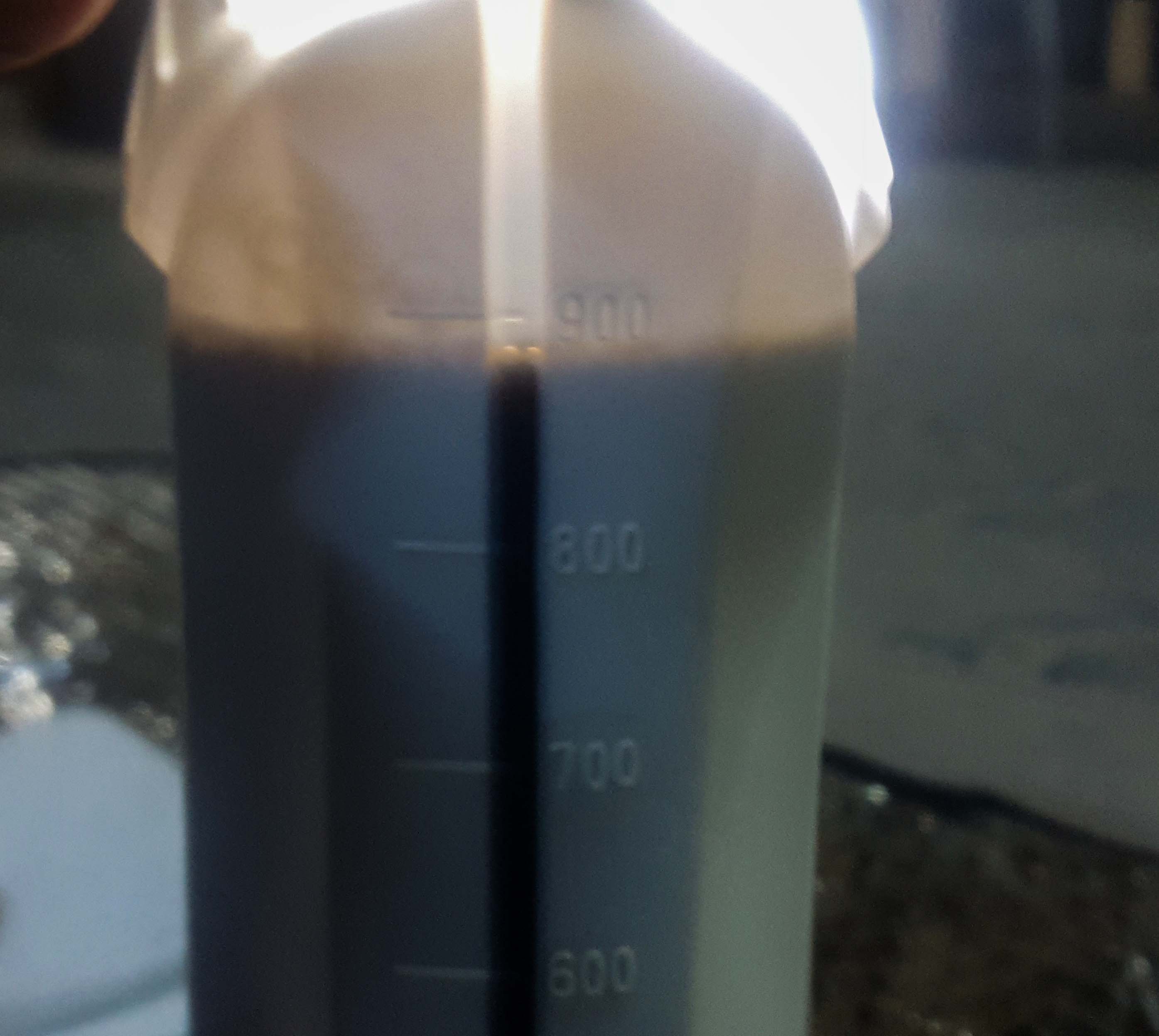

I changed the fluid with great effort on account of "no proper filler" at hand. I guess i managed to pore in approx. 830-840 ml. Some spillage was involved.
When i pored back the used fluid in to the bottle its just under 900ml (approx. 880-890 ml) as seen from the level window.
I do not plan to drive the car until i get another bottle to top it off.
Does Porsche account for some spillage when they give you 850ml bottle?
To be honest is am s%*t scared to take the car out for a longer drive. Just tested it for less than a mile. The sift felt better no jerks. Took 3-4 trials from stand still( 1st to 4th gear )

Ashish - I suspect Porsche put 850ml in, expecting you to use 850ml. I wouldn't be overly concerned about spilling 10-20ml. The oil is circulated through the transfer case by both the action of the chain running through the bottom of the case (below the fill port) and what appears to be some sort of pump flooding the clutch area (which is up high in the case.) It will continue to do this even missing 20ml. The only real effect the missing 20ml might have is to cause the case to run a few degrees warmer than if it has 850ml in it.
Share this post
Ashish,
Again - I wouldn't panic over 10-20cc spillage. The design of the case is such that 800CC would provide adequate oil to lubricate it. The only difference might be that a smaller than 850CC oil fill may result in it warming up quicker than normal. I wouldn't be concerned about it a lot, but since I know you, like I am likely an OCD Porsche owner - buy another bottle and use some sort of filler to get the oil to the level of the bottom of the threads on the filler opening.  That's the "official" level - which even 850CC's doesn't quite reach.
