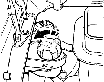

Draining coolant
1. Position the vehicle at the take-up points provided on a lifting platform.
2. Open hood.
3. Open tank cap on the expansion tank and remove.

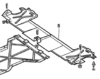

4. Remove the entire underbody cover.

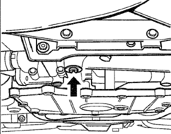

5, Drain cooling system. Remove the drain plug from the engine, drain the coolant into a container and dispose of coolant according to the country-specific legal requirements if no longer required.

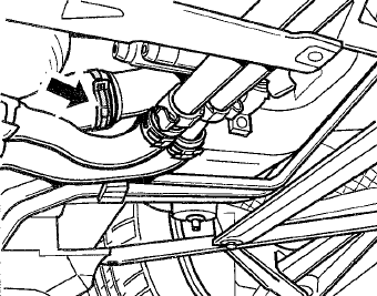

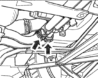

6. Pull the radiator supply and return lines off the engine. To do so, undo the hose clamps, carefully pull off the hoses and allow the remaining coolant to run out. Then clean the inside and outside of the hoses, connect the hoses again and tighten the hose clamps. Check whether the hoses are securely seated.
post-1-0-36565800-1288272339_thumb.png post-1-0-82167000-1288272342_thumb.png

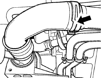

7. Open the heating lines on the vehicle floor. To do so, open the hose clamp, pull off the lines and drain. Then clean the inside and outside of the hoses, connect the hoses again and tighten the hose clamps. Install the hose clamps and check that the lines are seated correctly.

If you drain from the rear (closer to the engine), you should get a more complete drain as those hoses are lower at that point than at the front.
When I did a complete drain and flush, I attached a hose to one of the hoses at the rear and made a temporary seal at the garden hose nozzle and flushed it until the water coming out of the other hose right next to it was clear, then drained it thoroughly.
