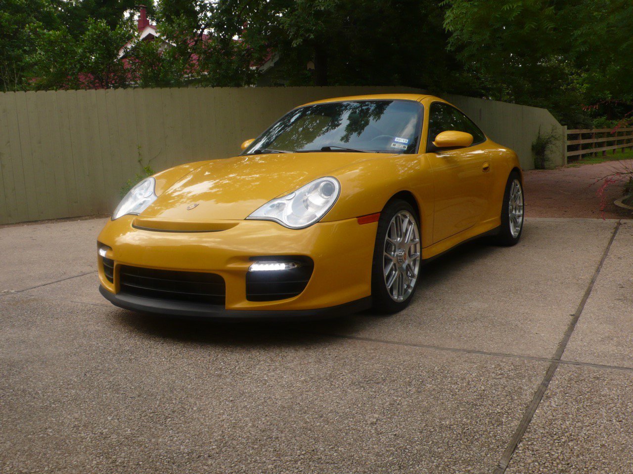

That's a great photo of a good looking 996.  2003?  Headlamps are end of 996-model style.

I replaced the bumper cover with a modified 997 GT2 bumper cover.  It was an aftermarket fiberglass piece.  It was so far off from fitting, not even close.
I already had the wrong one sold to me sold to me by another dealer so I was a concern buyer, the guy swore it would fit.  I probably have over 40 hours in fiberglass work to get it this close.
The big advantage is for the 3rd water radiator to have good flow through air...
Plus, I like the LED DTR lights....   Also, I have 3 front directional lights, 1 in the headlight unit, the LED DTR light has an amber turn signal light and we wired
up the fender side marker light to also be a directional light.
