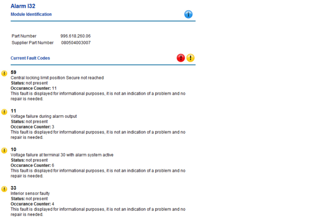

I've made a bit of progress on this issue! I was noticing my key being sticky in the ignition, so I replaced the ignition switch. Now, the passenger door does lock when I turn the key in the driver's door.
Unfortunately, now only the driver's door unlocks when I turn the key in the door. I need to get in, close the door and use the button on the dash to unlock the passenger door/storage. Also, if I don't put the key in the ignition and turn it within ~10s, I get a honk and then the alarm goes off.

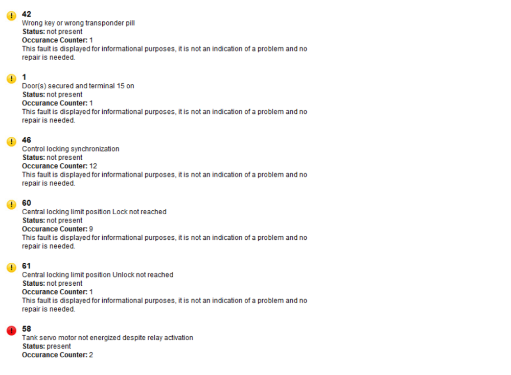

I got a Durametric and got the attached fault codes. I suppose the relevant ones are 59, 46, 69, 61, and potentially some others. Locking system seems generally unhappy, although not sure which codes are most relevant.

Sometimes these systems store a lot of secondary codes that confuse what is really going on. I would start by clearing all the codes and then see what comes back.
  • Thanks 1
Cleared the codes. First to reappear is the 58 about the tank servo motor. I assume this is talking about the fuel flap? I checked and discovered that the fuel flap does not lock when the car is locked. I assume this is not normal? I'll investigate further.

I replaced the actuator on the fuel flap. It seems to work some of the time, but it's unreliable (particularly unreliable when unlocking). The guide bushing is missing and I'm waiting for that part, but I presume that wouldn't mess this much with the performance. I don't have any fault codes appearing - any ideas?
Not really.  Get the bushing installed, if it still sticks, try spraying the plunger with DuPont's dry film Teflon spray (leaves a dry film of lubricant that does not attract dirt):
