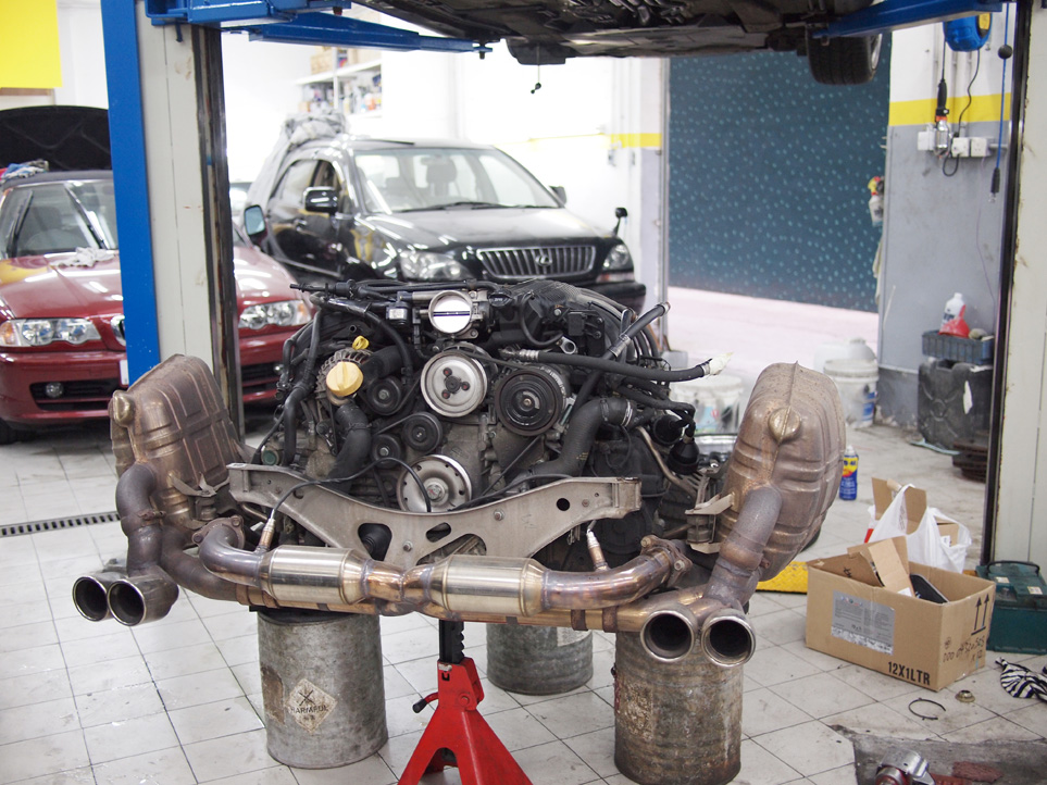

While I took my car to my mechanic for brake replacement, he had the car jacked up and noticed some oil leaking issues. I therefore asked him to look further by removing the plastic trims. From there onwards, we have noticed that some oil leaks problems.... only solution is to get it fix before it get worse.
The only solution is to have thew whole engine and gearbox removed (please see photo). After removal, we have noticed that the engine which has done 55000km of my car has been attached to the car since it came from the factory, i.e. has never been removed. Therefore, it is about time before something horrible happen.
Now, all these seals have been ordered and hopefully by the time it has been fixed, I will have a reliable car to drive for at least a few years.
