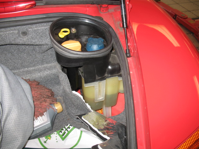

Coolant Overflow Reservior Crack I had been getting a flashing temperature light in my MY99 Boxster when I first started the car in the morning. If I turned the car off and then res
Thanks for the input. That was my thought a well but was told by both the service rep and the parts person at Sunset that I wouldn't necessarily see the leak in the truck. My concern is that it cr
you don't need any other parts. if you remove the carpet in the trunk, you can see most of the reservoir so you can inspect it for cracks. if it is leaking, PTEC is correct in that you will likely s

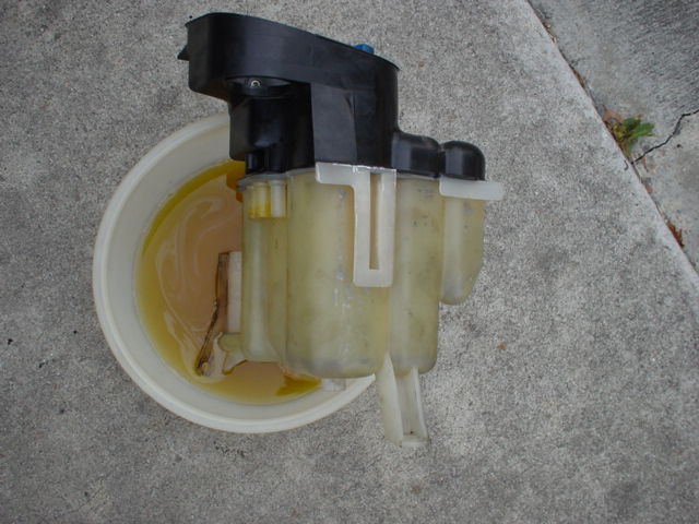

In case this helps anyone tackling this:
Got the **** tank out, the rough way.
Amateur i am, I chopped up the tank with snippers and hacksaw and drill to be able to pull on the end part better.

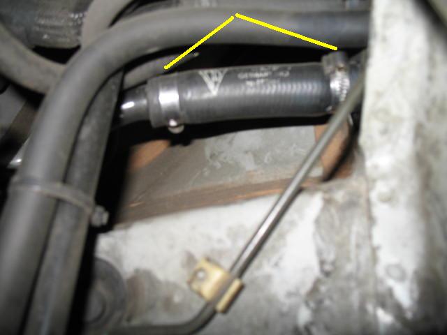

For others, this is where the other end of the 3" rubber hose connects to the metal tube in the engine compartment. This is the hose that the instructions say to disconnect from under the car, but I gave up trying to do it from under the car. The picture is taken from the top after the engine lid was removed.
Red X is the rubber hose. Green X is the metal tube. Yellow arrow is the new worm drive clamp that replaced the original spring band pesky clamp.

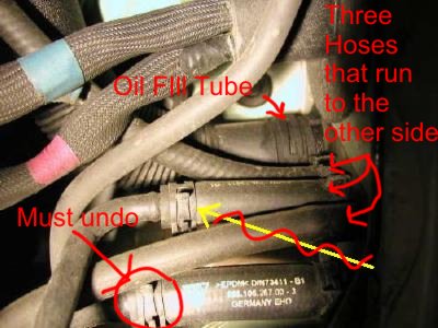

Just as an update to this. On my 99 Boxster this was quite easy and totally accessible from the top. I had the tank out in about 40 minutes.
The pic provided by tool pants (on my car at least) shows taking off the wrong clamp. If it wasn't for that it would have been a bit faster. Have a look at the pic which is attached. You can easily get to both of those clamps from the engine bay with a pair or normal pliers. I had the first one originally pointed to in yellow off in about 5 minutes and figured out it was the wrong one, then did the one I marked in red at the bottom in about 2 mintues as it's easier to get to and had the whole tank out in no time.
Seriously I could re-re one of these in under an hour now, so don't be afraid to do this yourself it's a piece of cake.
Pic:
Top hose is the oil fill tube, no need to undo this it's attached to the plastic plate that runs into the trunk.
Next three are the three that run through to the tank attached to the plastic plate as well. No need to undo any of these in the engine bay.
The very bottom on, the largest hose is the one thats attached to the tank and the one you will need to remove. It's easy to get at from in the engine bay. I'm 6.0' and 175lbs and have good sized arms and could get in there no prob. Once you undo that the tank pulls right through with no problems at all. I ordered my tank from my local Porsche today for $250 so I will have it back up and running in no time.

I recently purchased a 2001 boxsterS, and about a week after, I noticed a antifreeze leak under both sides of the right rear wheel, then remembered my earlier research here on the board.
Pulled the carpet up and sure enough, it was wetter and stickier than I was when I first drove a Porsche :clapping:
Tip# 1. I figured that it might be a while before I get a replacement tank, but I didn't want to have the antifreeze slooshing around the trunk area, or leaking onto the ground, so I got a roll of paper towels and would place a few rolled up sheets on the floor under the styrofoam everyday to suck up the fluid until the new tank arrived.
The paper towel trick worked very well, kept it contained and stopped the drips onto the ground.

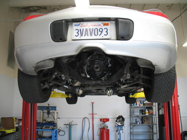

2 1/2 years after I replaced the plastic coolant tank my car is on the lift for a clutch replacement.
With the transmission out you can see all the hoses. I had flashbacks.
Now I can take a decent picture of the 3" rubber connecting hose. And you can see the 2 worm drive clamps that I used.
