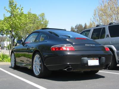

Folks, I am due for new tires front an back . I have the 18 inch Porsche rims, see attached picture ( 225 front , 265 back).
I am going to drive in the rain for the next 4-5 months followed by a nice California summer, mostly on Freeways. As such I am looking for low noise, reasonable wet weather traction, dry road traction and braking as good as possible I am not particularely concerned with the N1-2-3 crap ( am I wrong here?). I have ContiSportContact 2 ( N2) on the back , Contisport On the front ( 20K miles). They were pretty acceptable BUT noisy ( especially in the last 6 months or so ie half worn) and I felt they were not too grippy ( but OK ).
Tell me which ones and why please.
