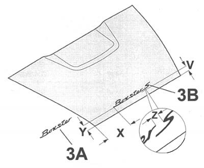

We did this for all Carrera variations so it's time we added for the Boxster's too.
Measure the position of the logo with a measuring tape according to the model variant and affix it to the rear lid.
Logo Boxster -- 3 A dimension X = 285 mm and Y = 45 mm
Logo Boxster S -- 3 A in connection with the letter S dimension X = 245 mm and Y = 45 mm
Logo S -- 3 B dimension Z = 20 mm and V = 40 mm

How to get an accurate position? I was thinking to use water with soap to adjust position easily, then when dry it wil be fixed.
Share this post
What i did when placing my 986 emblem was that i used a tape measurer and meansured 33 inches across from the current location of the boxster emblem...basically left to right at the horizonal position of the emblem across the trunk., I placed the 8 from the 986 emblem at the 16.5 inches mark and the emblem about 3 inches from the top of the emblem to the bottom edge of the trunk lid.
