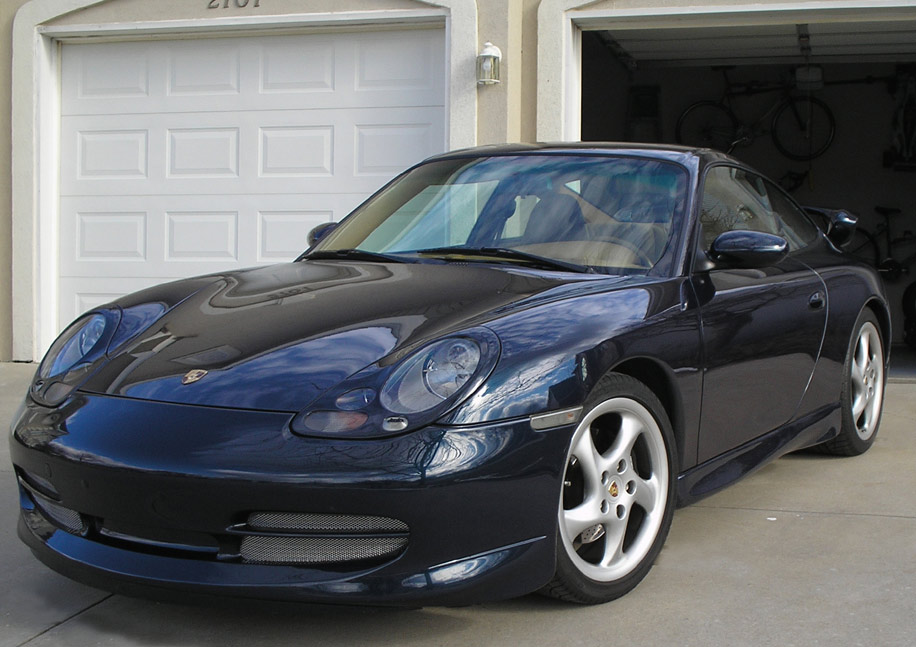

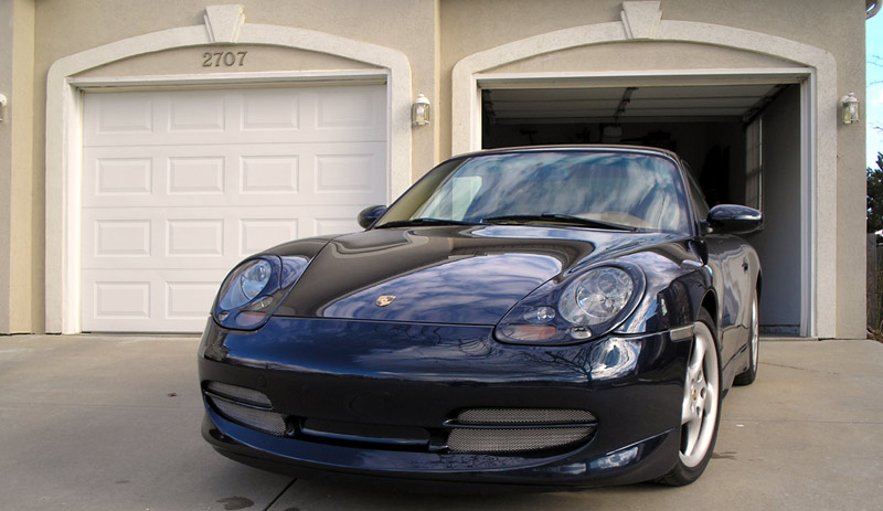

I haven't seen much online, but I was able to fashion a set from stainless aluminum I purchased on eBay. Many people use cable ties to fasten them, but I did not like the way it looked. I flipped the bumper cover up on end, and used 2 part epoxy (plastic steel), and used 4 small bolts (glued the heads in first to the trim piece in the middle. then formed the mesh, and slid down over the bolt threads from inside, and used lock washers and nuts. I think it came out pretty good...Though I am no expert. I attached a photo of mine (I hope...first time I tried:)). It is a GT3 front, but similar to boxsters and original 996. Good luck!

rock, looks nice. Any close ups of the mesh?
I like the headlight covers too. Where'd those come from? How have you liked 'em?
Hi, Thanks.
I have tried to attach some close-ups for you. I saw the ones on the link below, and was not terribly impressed (although
they are probably better than mine:)). Sorry for the large file size, but that wa sthe best way to get a close-up.
The grilel material can be purchased on eBay for not too much $$, and it was actually a little fun to make them. I took apart
the care, cut the grilles, glued the bolts, waxed and re-assembled in one weekend (time for glue to dry too....)
As for the covers, I really like them. I had to paint them to match (ocean metallic blus), an they fasten with the double sided
moulding tape. I used an entire roll.....you know....so they don't fly off at 170 MPH :) I got them from a guy in Germany a while
back, but have also seen similar ones on eBay.
