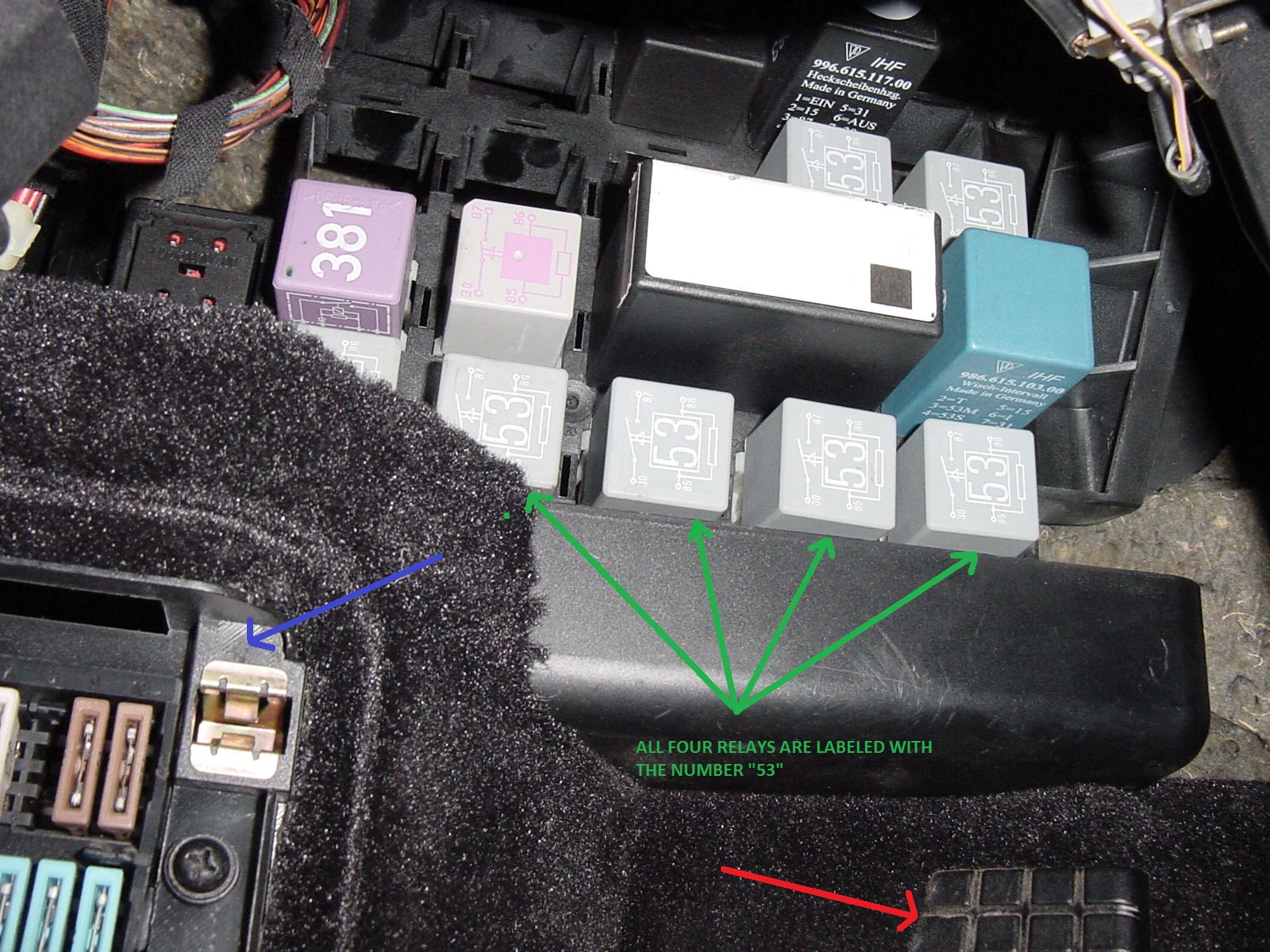

The relays are located on the bottom row of the relay tray (there is a row below that one, but it's "unoccupied"), which is mounted directly above the fuse panel, high on the kick panel by your left calf as you sit in the driver's seat.
Here is a photo of the relays and their location:
post-6627-0-03656200-1299212239_thumb.jp
The red arrow points to the top of the "dead pedal", the blue arrow points to the top right of the fuse panel, and the four green arrows point to the fan relays. Note that the number "53" is washed out in the photo, but it should be on your relays.

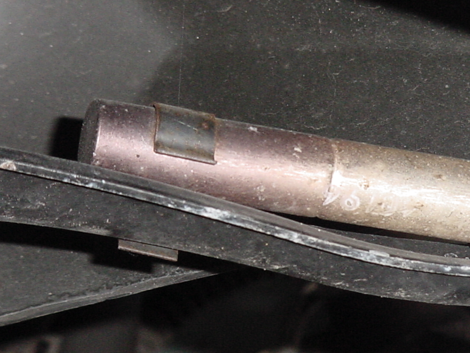

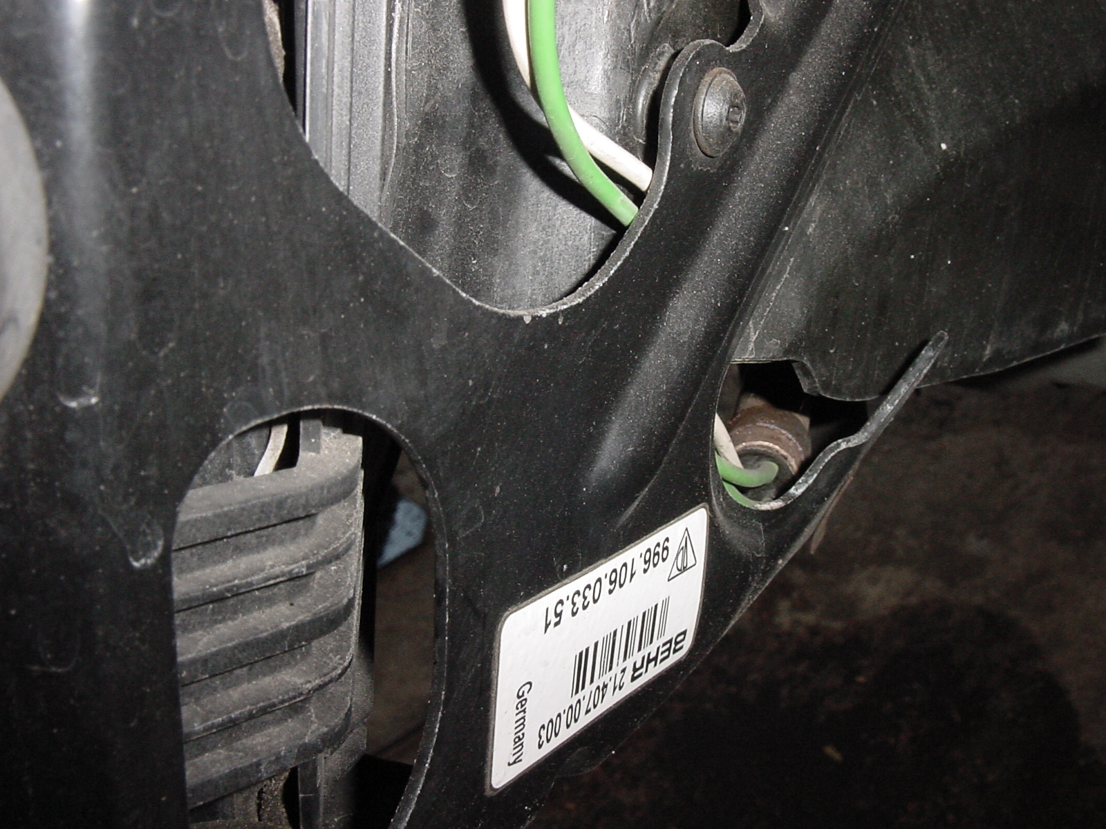

The resistors get hot and when they get splashed with cold water or rain, they crack internally and go bad.
Here is the ballast resistor (at the end of the green and white wires):
post-6627-0-96134100-1299213616_thumb.jp
