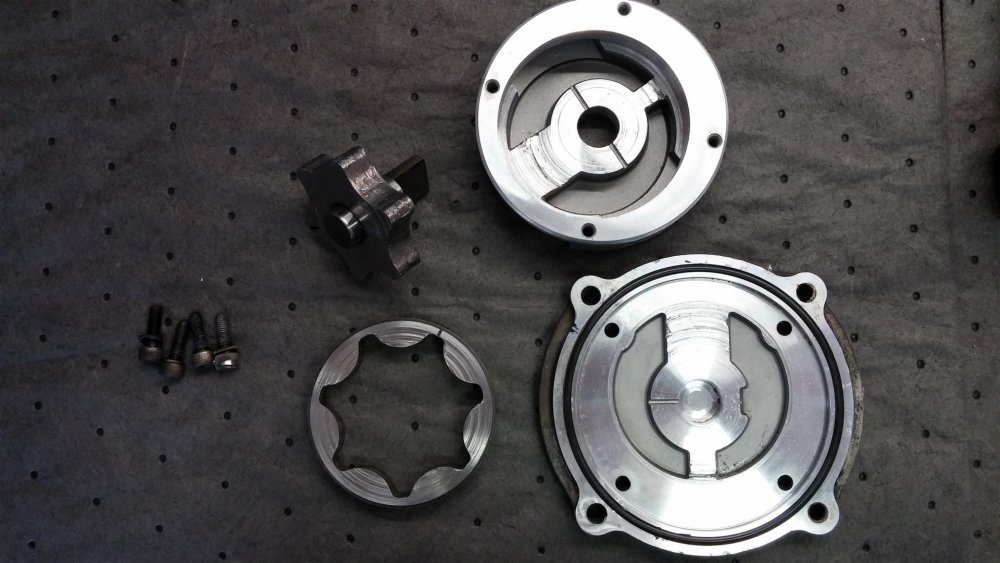

  5. This is how the internal of the pump looks like. This pump ingested some debris hence the damage.
  6. Yes, a regular 3.4 also has a scavenge pump on each bank.
  7. Yup, that's the bank 2 scavenge pump. Can be removed (if enough space) without removing the cam cover. Hard to imagine it making such clanking noise though. You can use a mechanic's stethoscope to pinpoint the source better.
