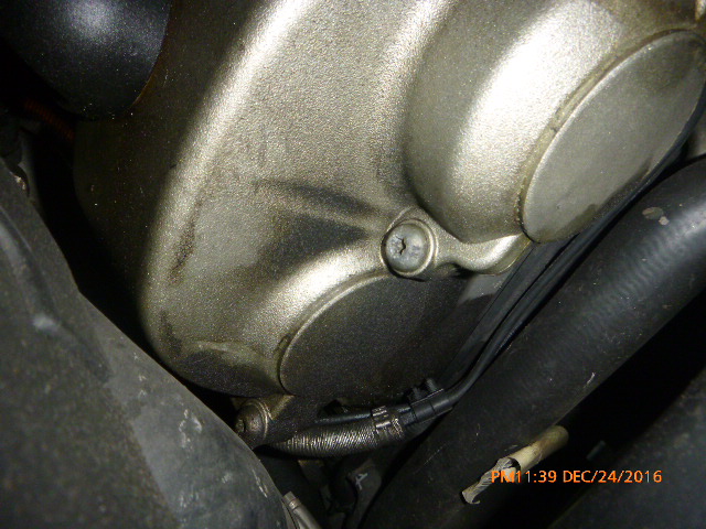

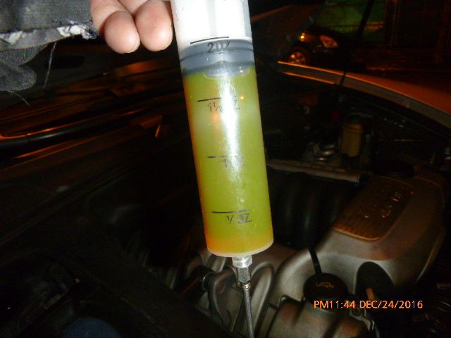

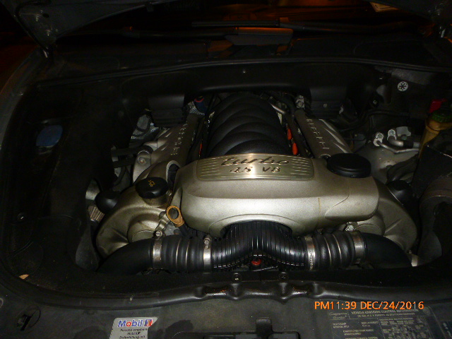

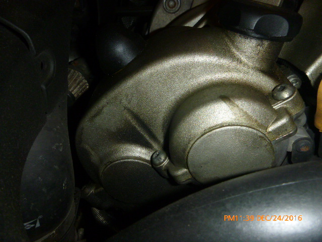

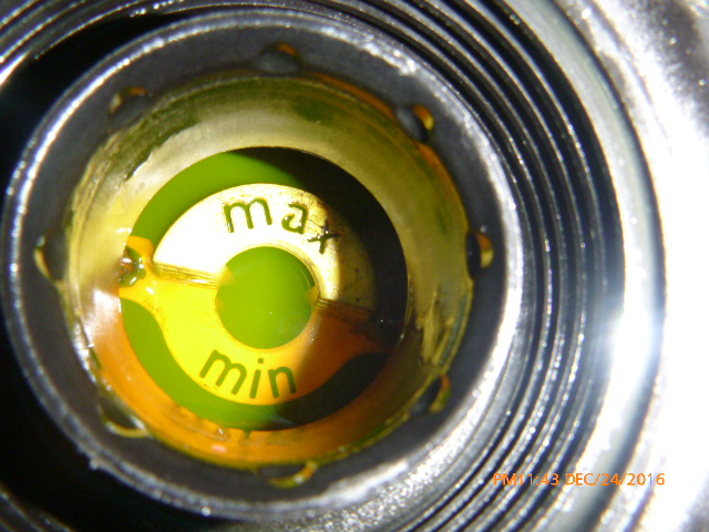

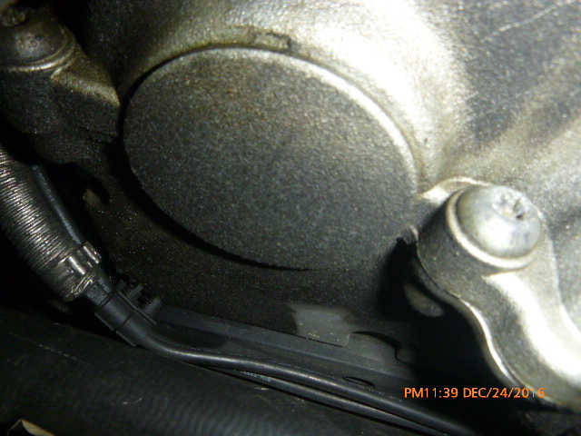

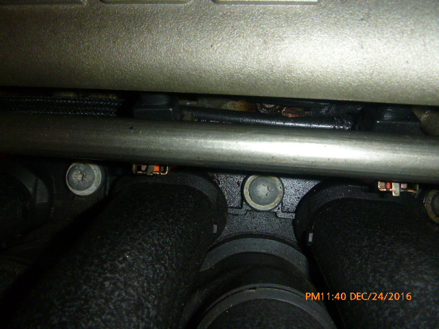

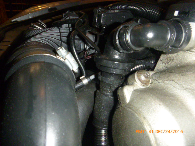

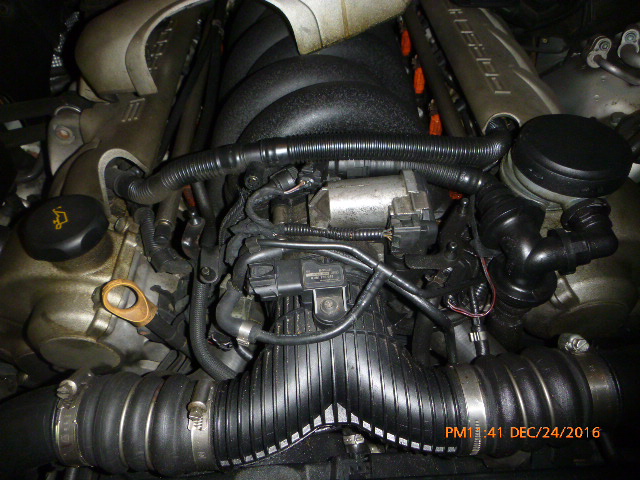

  2. Morning Big. Coffee? It's got just under 131K miles. Not sure what let loose. The fan is spraying oil all over the place so it's hard to tell where it's coming from. I'm thinking it's one or possibly both head gaskets because the coolant definitely has oil in it, thankfully not a lot but it's in there. Some how it doesn't smell like fuel though, still smells like fresh sweet coolant so this is definitely a new thing. Odd thing is I've still got decent power delivery and gitty-up! No bangs, bucks, CEL, hard starting, only a low oil light and then the discovery. Both valve cover gaskets were already weeping and I had an appointment scheduled next week to remedy those anyway. They seem to last about 2 years because every two years at this same time I have to have them changed. I was planning on doing a full fluid and filter swap anyway. I guess now I'll plan on doing a rebuild or engine swap. Well, at least Santa has a sense of humor then
  3. An oil warning light, oil everywhere, a horrible rattle rattle and an untimely huge repair bill! (You gotta say it to the tune of the 12-days of Christmas. At least that way it's tolerable.) P1000116.wmv
  4. yup. seems like every 2 years I'm replacing mine. last time was December 2014, left bank was leaking so replaced both.. Guess what? gotta leak again this time from right bank.
