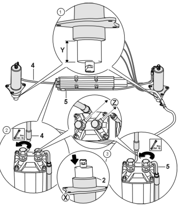

I've read these instructions several times and they don't make sense. I think where they say to TIGHTEN the hydraulic line until the cylinder moves, it should be translated to LOOSEN the hydraulic line until the cylinder moves. It seems that you would have to loosen the fittings to bleed out the air bubbles. (???)

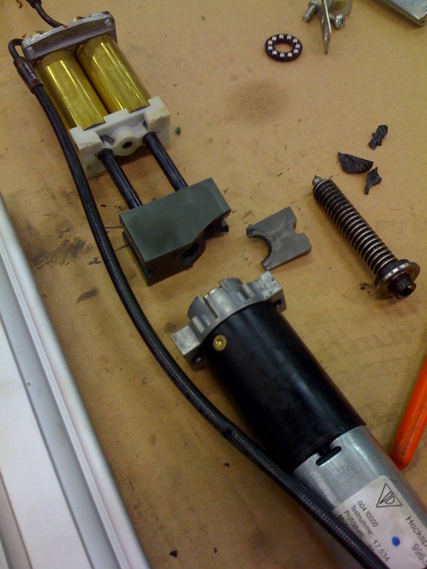

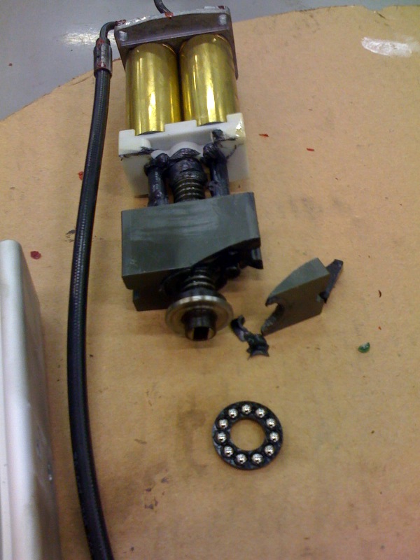

I've been following this problem here and on 6speed and nobody was able to replace the seals because they cannot purchase them separately and they are unique. (I never dismantle one myself) Some people on 6speed used thicker oil to fix their leaks...Did it last ? We don't know. I saw one thread on 6speed were the guy completely dismantle both rams and pump to found out that he was not able to replace any internal parts... So far the only solution, if your keeping the movable spoiler, keep an eye on Ebay for a used mechanism. There was one, a couple of months ago, who went for less than $200.00. Having two complete system help to build a good one... If you got any success in your attempt to fix the problem please do not hesitate to share your findings. Thanks, J.P.
post-29683-127050611027_thumb.jpg post-29683-127050617616_thumb.jpg post-29683-127050616055_thumb.jpg post-29683-127050630569_thumb.jpg

If you do not feel comfortable doing this procedure please take your car to a shop that has experience doing this. This is straight from the factory manual. Bleeding the spoiler pump unit post-1-1178510134_thumb.png 1. Pulling out pump Pull hydraulic cylinder 2 out to the dimension Y = 35 +2 mm . To do this, connect 12 V to the pump. Observe polarisation arrangement A. 2. Bleeding short hydraulic line Slowly tighten short hydraulic line 4 until the hydraulic cylinder 2 moves. If the hydraulic cylinder has reached the lower mechanical stop inset X, push back onto the stop if necessary, hydraulic lines must be laid parallel to each other inset Z. Tighten banjo bolt 3. Tightening torque: 15 Nm (11 ftlb.) 3. Bleeding long hydraulic line Slowly tighten long hydraulic line 5 until the hydraulic cylinder 2 moves. If the hydraulic cylinder has reached the lower mechanical stop inset X, push back onto the stop if necessary, hydraulic lines inset Z must be laid parallel to each other. Tighten banjo bolt 3. Tightening torque: 15 Nm (11 ftlb.) Note: Use only Pentosin CHF 11 S (or it's replacement).
hi loren, is it me or does this not make sense to you as well? how do i really bleed any air out of one or both of these cylinders...after filling the cylinder to the top and reinserting the banjo bolt and tightening and catching/blotting the overflow, there is still air? and that side lags behind when raising, pretty severely...what is my next step? many thanks, kevin

yes, checked for leaks,there was weeping at the bottom of both cylinders, i replaced the copper washers, filled and tightened, but how do you bleed each line by tightening the line and THEN tighten banjo...isn't tightening the line in fact tightening the banjo? , cheers, kevin

Is there any update to this? To bleed the system, you simply add 5mL to each ram, then tighten the banjo? Do you need to remove the rams from the car?

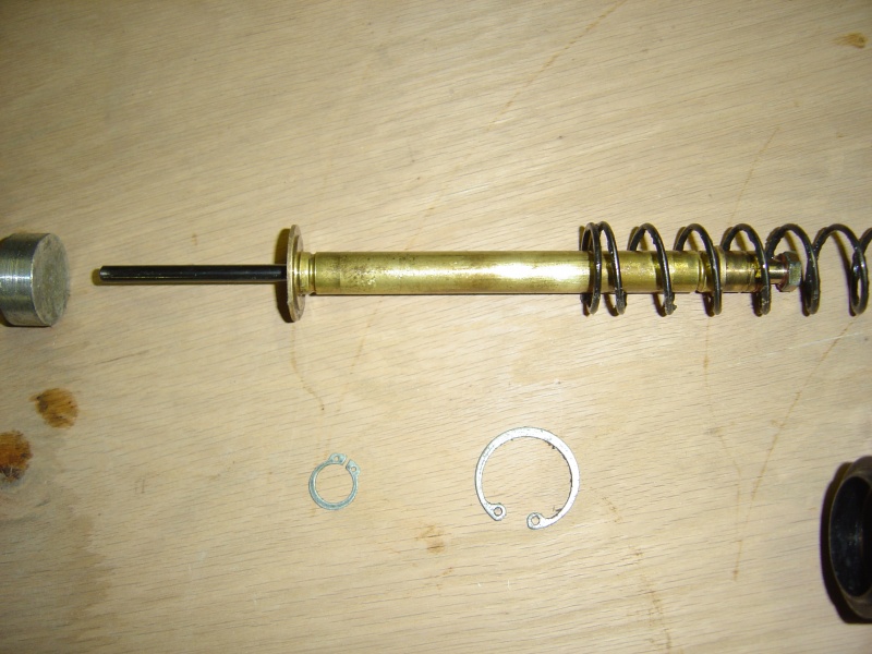

The retracted rams only take about 1 cc at most. I just rebuilt my leaking ram. Requires disassembly of ram and removing the brass tube. Inside the brass tube there are two small metric orings that have to be replaced. This was not an easy fix as the brass tube has to be cut and welded (silver soldered) back together. Seals $2.00. welding $75. Total- $77.00.
Most of the fluid goes in the retracted main pump.
