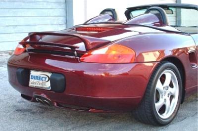

I added this wing because I like the look of it on the Cayman. I'm not about bling; just think it updates the look on the car. BTW, I get alot of compliments and our Chicago National Concours judge/champion liked it so much, he ordered one.
Wow, I think it looks great!
So, is it aftermarket, or cayman one? How much did it cost?
Was it complicated to change?

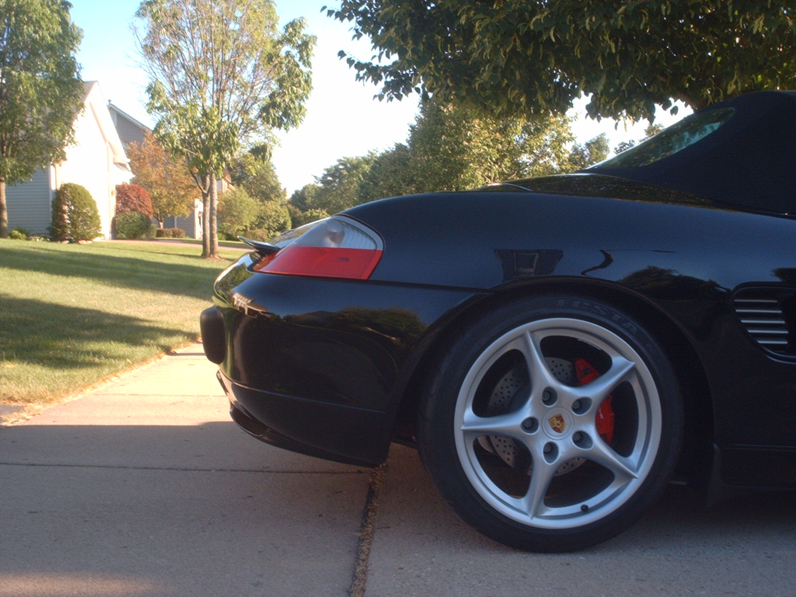

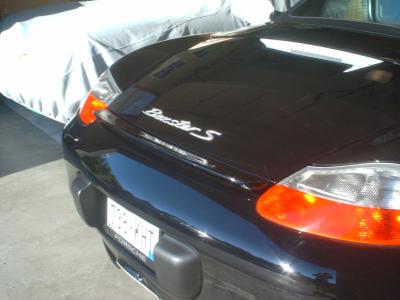

Here's a couple more of my dusty car...the sun angle was brutal, so they're not the best, but it gives you an idea.

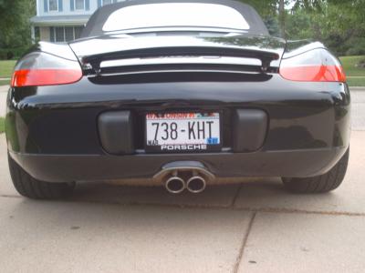

One more...
Edited by jmatta
One more...
The spoiler looks fantastic!
Is your spoiler a standard Cayman one? How much did it cost?
And any difficulties on installing it?
