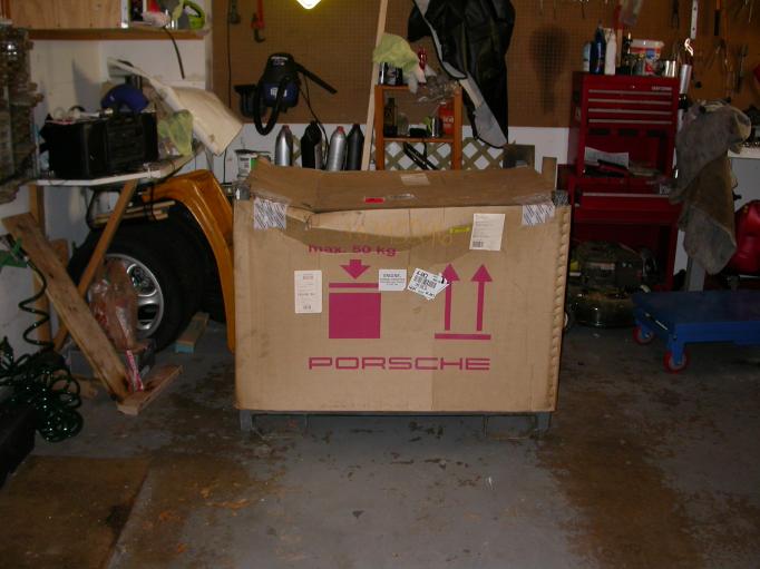

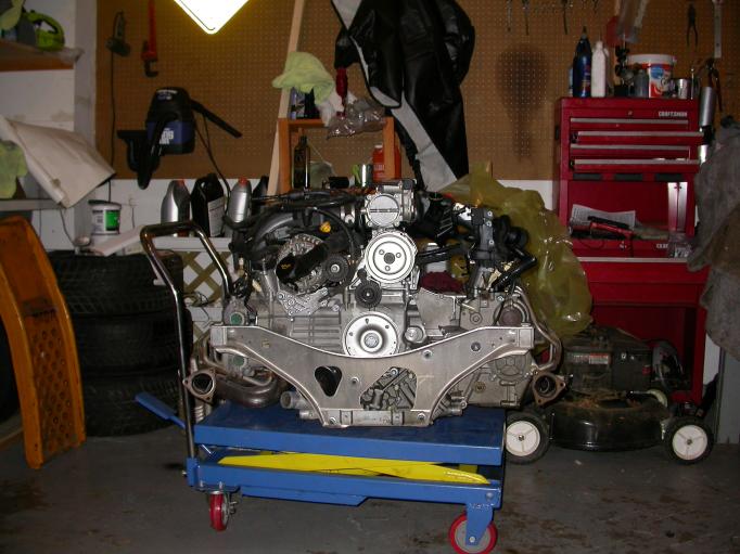

Hmm wonder what is in the box???
Looks like a 2005 3.6L engine.
Should be fun.

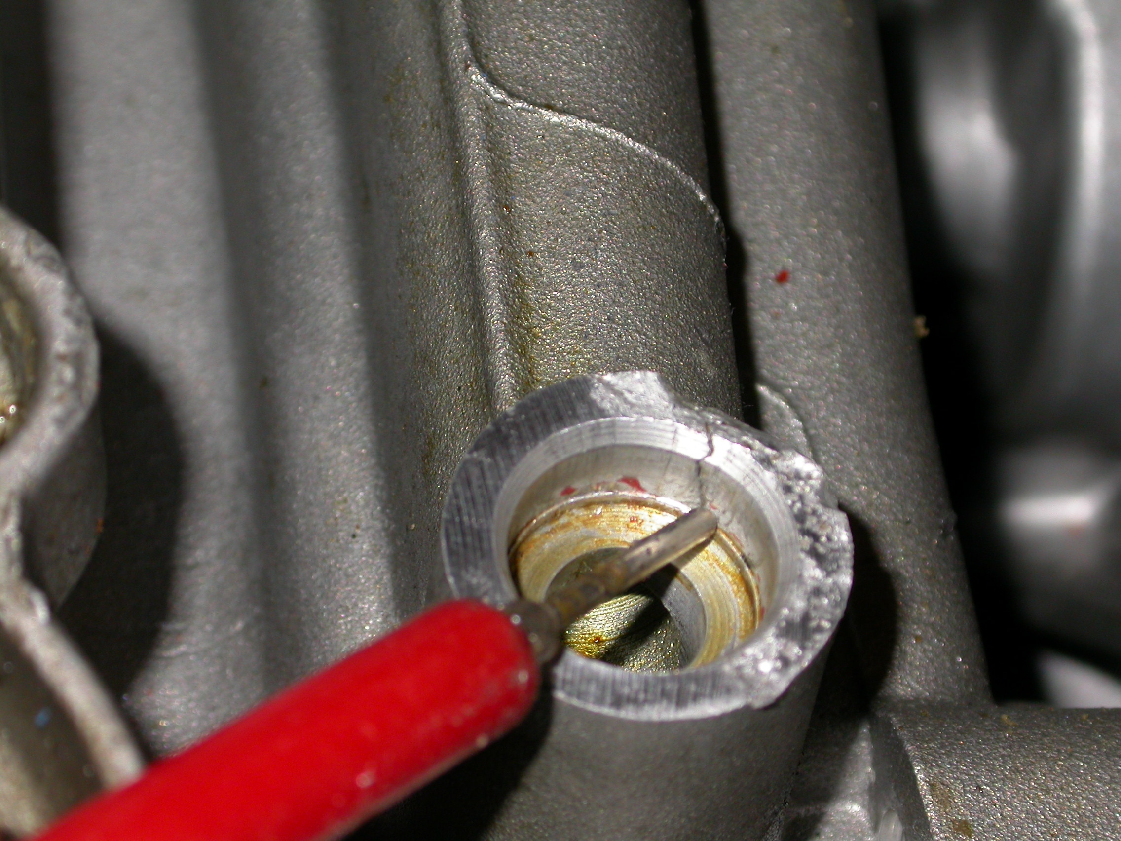

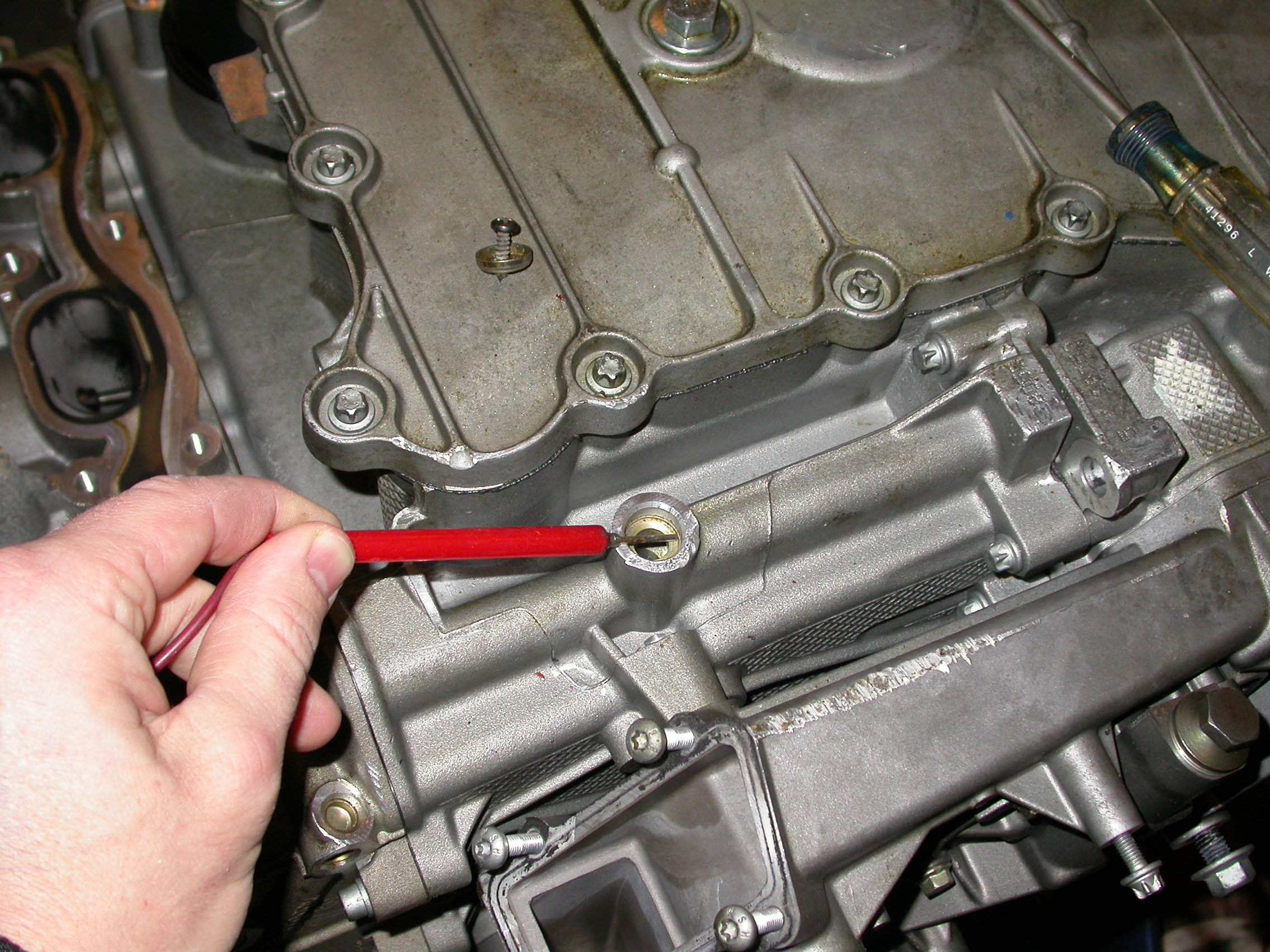

A little info on my motor I found out.
It is a factory reman motor, installed in Dec 2005. The car it was installed in backed over a parking curb and according to the dealer had an oil leak caused by a crack in the case, they wouldn't fix it so it was replaced, paid for by insurance. The engine has 2600 miles on it.
Below shows the 'crack' in the case.
and the location of the galley boss on the case
Yep that is is, it is only in the oil galley plug casting, surface crack, the leak was probably because the oil galley plug (gold coloured plug with screw in it in the second photo) was knocked loose, a new oil galley plug and a little JB weld to fill the crack just in case and it is as good as new.
Todd
yeah no big deal. Thats nothin some miracle JB Weld won't fix up. I would probablly put a hose clamp around that tho for a while just to make sure vibration etc doesn't cause the casting to crack anymore. I say that, even though I highly doubt that would even happen.
