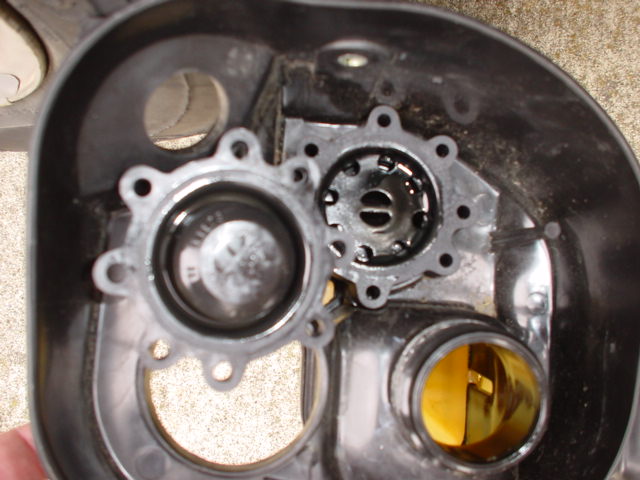

Some images and new information. Any and all help is great appreciated as always.
The drain whole steams when I stop after a 10 minute drive and it looks like there is fluid coming from the bottom of the bleeder valve area. Not sure if it was leaking down from the bleeder valve or just somewhere from there. Is it even possible for a tank to lank from there?
Also are all coolant reservoirs OEM? I am beginning to think the shop I went to used some aftermarket one since it has no Porsche markings or numbers on it anywhere and is from WorldPac (in San Jose, CA).
I think I will be taking it back to the same shop I have been going to since the problem is getting worse and worse after only 3 days and maybe 6 short trips of less than 10 minutes each on a new tank.
Also strange. The coolant tank was made in April 2007, but has this bleeder valve on it:

After have 2 new coolant tanks installed by an incompetent shop I finally emailed Porsche_Joe over on PPBB about the write up he did a while back since I was confused. He was super nice and gave me some useful tips. So I did the procedure with his new information and took some pictures so everyone can share in how to solve the quite common coolant condensation on the inside of the trunk lid problem. ENJOY!
COOLANT BLEEDER VALVE O-RING REPLACEMENT PROCEDURE (from Porsche Joe)

7. With the housing removed you will see the two o-rings on the top of the coolant tank. I sprayed some silicone lubricant on the new rings before installing them (yea, yea, yea, I know, silicone lubricant accelerates the deterioration of rubber but that’s what I had available at the time). The lubricant will help keep the rubber o-rings from sticking during assembly. Instead of silicone lubricant you could coat the new o-rings with a thin coat of liquid soap or even use something like Vinlyex. Remove the old o-rings and install the new ones.
Small O-Ring:
Large O-Ring (old one from “brand new tank” on left, real new OEM Porsche right)
Both O-rings on the bleeder valve top

Two observations. Most likely the shop did use a non OEM coolant tank, but it probably didn't come with a bleeder valve. They used the bleeder valve from your old tank and tried to do the right thing by replacing the o-rings. Most likely, they pulled some generic o-rings out, which seemed to be the right size and used those. I think this was ultimately the cause of the problem. By switching back to the OEM o-rings, you solved it.
Another observation about this thread, in Tool Pant's earlier photo where he seems to have a simpler bleeder valve assy, I think he may have stopped one layer short of where you did, and thus, didn't encounter the o-rings.

When you pull the bleeder valve apart, be sure to check the large rubber diaphragm on the underside of the bleeder valve cap. It that diaphragm has a pinhole or if the diapragm rubber has "expanded" from constant exposure to the coolant over the years, it will leak or it will not seat and seal properly.
If that is the case, you can buy a completer bleeder valve assembly without having to replace the entire tank.
The most common cause of this condensation is the O-rings.
