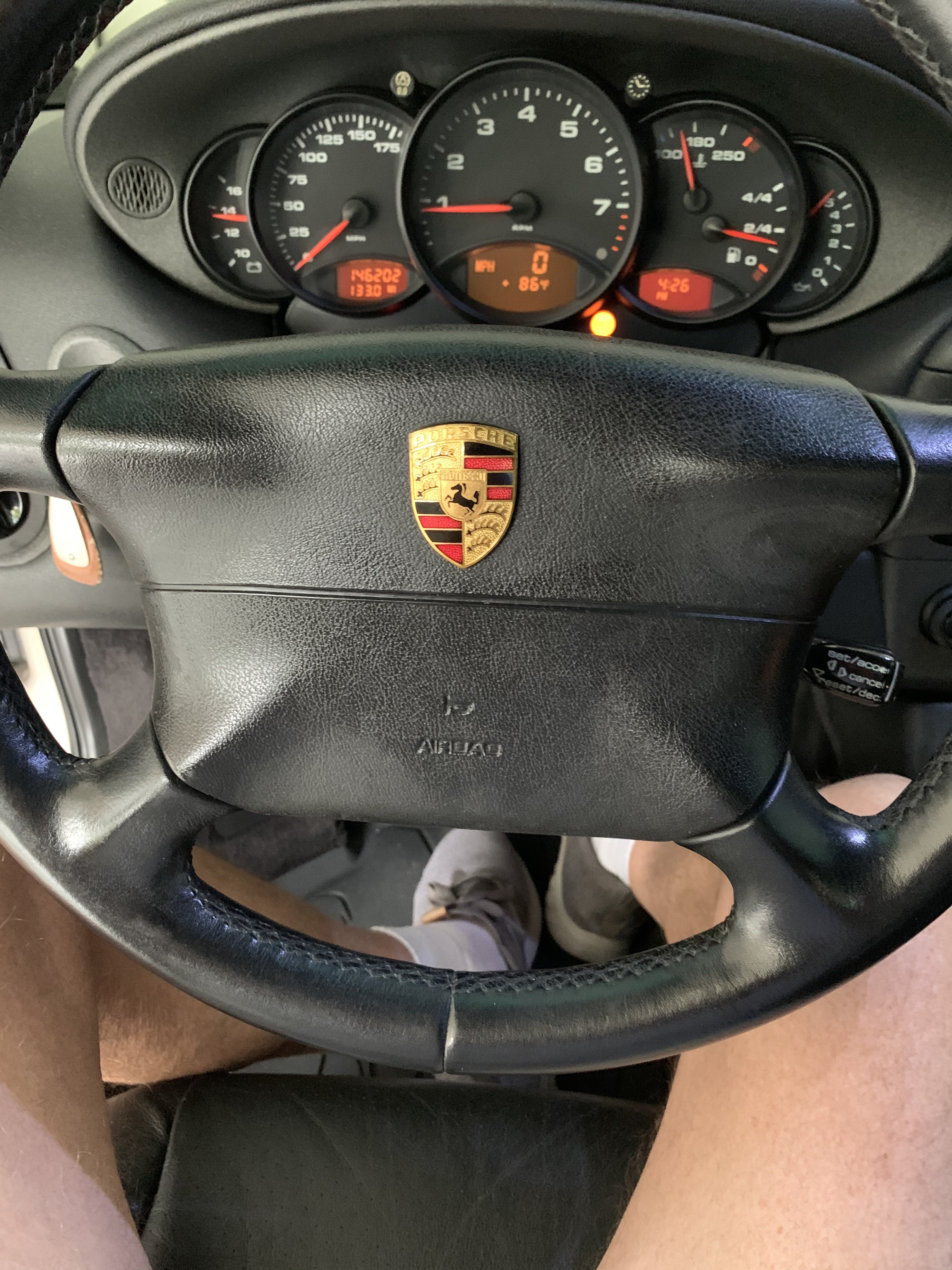

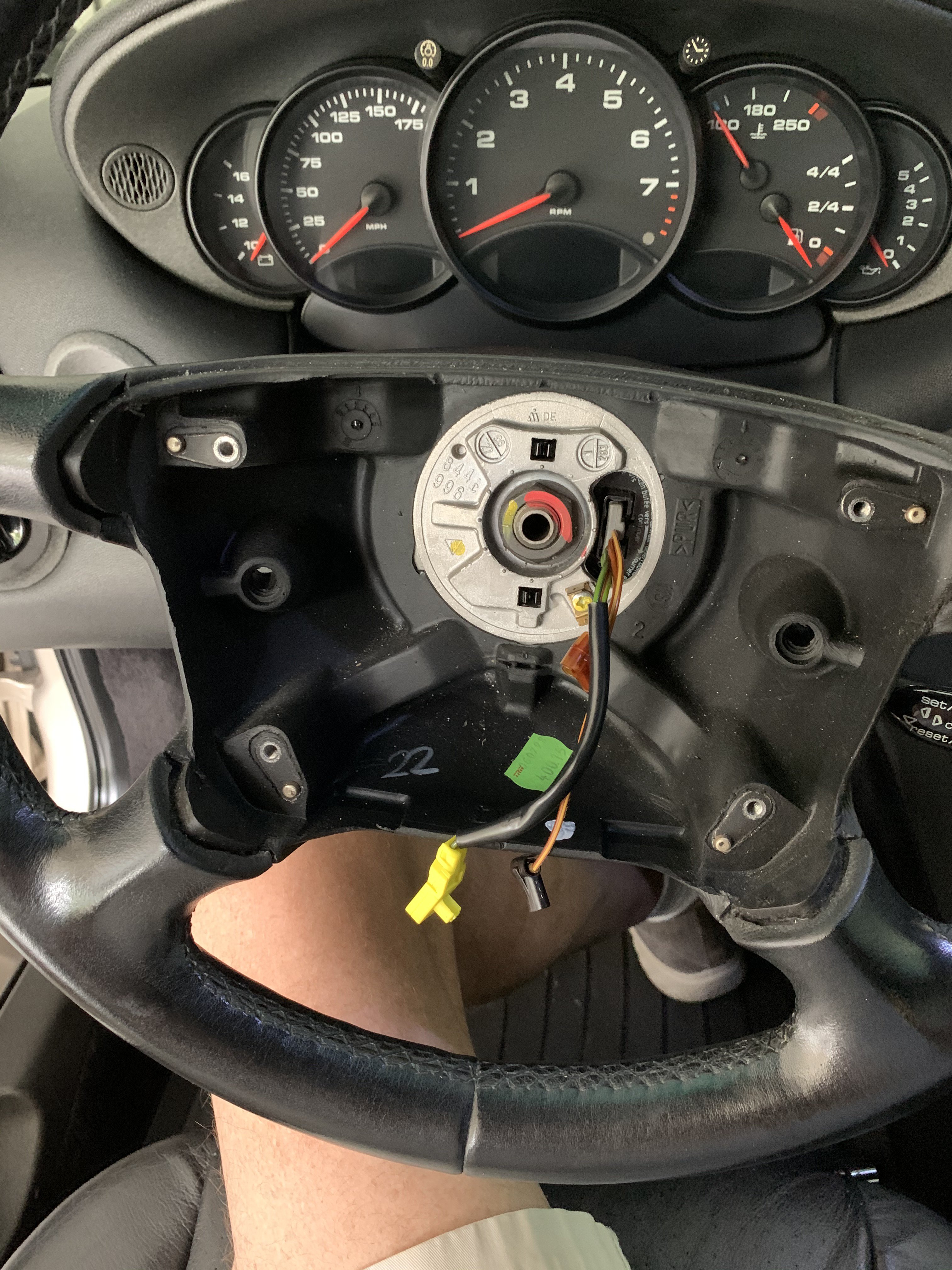

I wanted to document my project so it might help the next person.  Problem - horn honking when going over bumps.  Pulled B3 fuse until my new horn frame came in.  I noticed in some previous post they said use a T30 bit.  Mine is a 99 C2 four spoke steering wheel.  The correct bit is a T27 for the air bag bolts.  They were definitely tight so I bought a right angled tool. I ran the car and turned the steering wheel so I could easily access the two air bag bolts at 6 o'clock.  It was fairly easy.  I held on to the airbag and undid the bolts.  Turned off car and removed the key.  Gently lowered the airbag.  The yellow connector on the back of the air bag simply unplugs, pull it off and set the air bag aside.  The four bolts that hold the horn frame are 17mm and come right out.  A reverse of the procedure is all it took.  The air bag bolts must be in the back side of the horn frame, so I used some small sections of rubber hose to hold the bolts in place until I got the frame bolted in, then removed them and put air bag in place.  That was about it. The rubber bushings on the old horn frame were basically gone, thus the horn honking going over bumps.  I did not undo the battery and the air bag light did not come on after I was done.

On 3/5/2012 at 7:11 AM, odys996 said:
Does anybody know the torque setting of the 4 bolts for the frame, and the two torx screws for the airbag?
In doing my project yesterday I did notice that in removing the (4) bolts mentioned, they were tightened not much more than hand tight.  "Snug" would be a good term.  I'm also not sure what material they may screw into.  It may or may not be metal but even if some form of a metal bushing, the bushing is likely mounted to a non-metal portion of the steering wheel.  [Edit] I found that the Bentley manual specifies 5 #-ft (6.8 Nm) for the (4) bolts.  I also found a copy of the Porsche Technical manual and at least for MY2000 the torgue for the T30 Torx screws is specified as 7.5 #-ft (10.2 Nm).
There was no indication of any thread locking material on (3) of the bolts, but one had some residual of a red material.  There is a red Loctite but it is for high strength high temperature applications.  When I replaced my bolts I simply used clear nail polish.  I also used clear nail polish for the (2) bolts that hold the air bag on.  As a mechanical engineer, I'm reluctant to use blue Loctite on small fasteners, especially when they are recessed into a blind hole.  Strip the head on one (as someone mentioned they did) and you have a serious project on your hands.
Edited by John from PA
Torque spec is  44.5 inch pounds.
