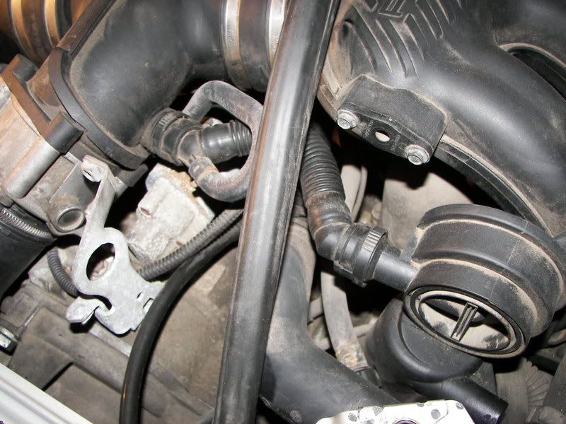

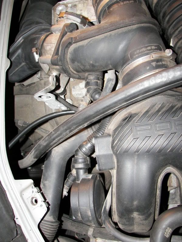

My parts for a new AOS arrived yesterday, and I opened up my engine bay and am noticing some serious differences between Mike.Focke's explanation and pics of the AOS.
He explains that you need to "Remove the J-tube connecting the oil separator to the throttle body..." Well... I can't find a J-tube that looks anything like what's on my car. Upon closer inspection of this picture... this doesn't exactly look like the same setup mine has.
Here's the image from Mike Focke's site:
And here's mine:
Notice, there is no J-Tube, but there's a Y-tube in front of the Throttle body. ??
Here's a different angle shot.
I'm confused... now I'm not sure if I have the right parts for this job.
thoughts?

Thats because you have a newer e-gas boxster so the tube is different, If you ordered parts that look similar to what is in your car now then your fine. Oh yeah, just unsnap the y-tube and proceed with removing the bellows tube, 2 10mm bolts and snap hose from the bottom of the AOS underneath the car.
Hmmm I must not have done my research this time... what's the difference between the "e-gas" boxster, and the other one? Also, I ordered the "J-Tube" so I'm not sure what the part # (or #s) that I need instead. I was replacing the AOS as a precautionary since I'm creeping on 75k. Didn't want to take any chances... unless there's a difference between the e-gas one and the other one where I don't really have to replace the AOS because it's not an issue?
I guess what I'm asking is... since there's no J-Tube on my car, do I need to replace that Y-tube assembly instead? If so, is there a part # (or #s) associated to what I need. All I ordered from before was the J-Tube, the AOS, and the Kluber Glep.
Edited by usaf-lt-g
The AOS is the same whether e-gas or not... the new AOS may look different to the one on your car but it will fit ok. Clean any oil out of the Y-tube you've got and return the new J-tube. Did your AOS come with a new bellows pipe for the bottom connection? If not you will need a new one.
Yea I ordered it from Sunsent, the bellows is already attached to it. So you're saying I can just re-use the Y-tube I have and there's no need to order another one?
Hairy is right, you will have to return the Jtube if its Jshaped, if its a y shaped tube them your fine, you could use it.
E-gas Boxsters have electronically controlled throttle plates like a servo on a remote control car, as opposed earlier boxsters that have the old fashioned cable and spring tensioned throttle plates.
Your AOS should come with a bellows hose/ rubber accordian hose already attached to the AOS.
Yeah you could reuse the old one assuming it isnt cracks or split and the seal at the connection points are air tight.
I think the newest AOS part number ends in 04, I just replaced mine last weekend and the AOS ended with .04 and the J-tube for my non-Egas engine ended in .05
