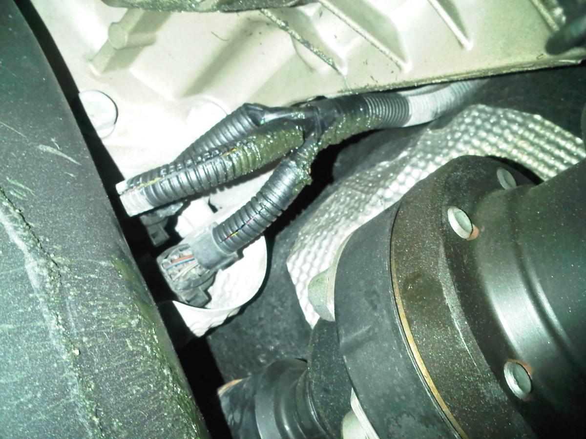

Yeah, its parked for sure.. I just crawled under there and found some bearing grease sprayed from the front drive shaft where it enters the center diff. Also, the shaft slides back and forth easily about an inch. I havent read any posts about front shaft bearing failure. I hope to get it towed to the shop this week or next but I'd hate to take it across town and discover its something I can do in a few hours.
