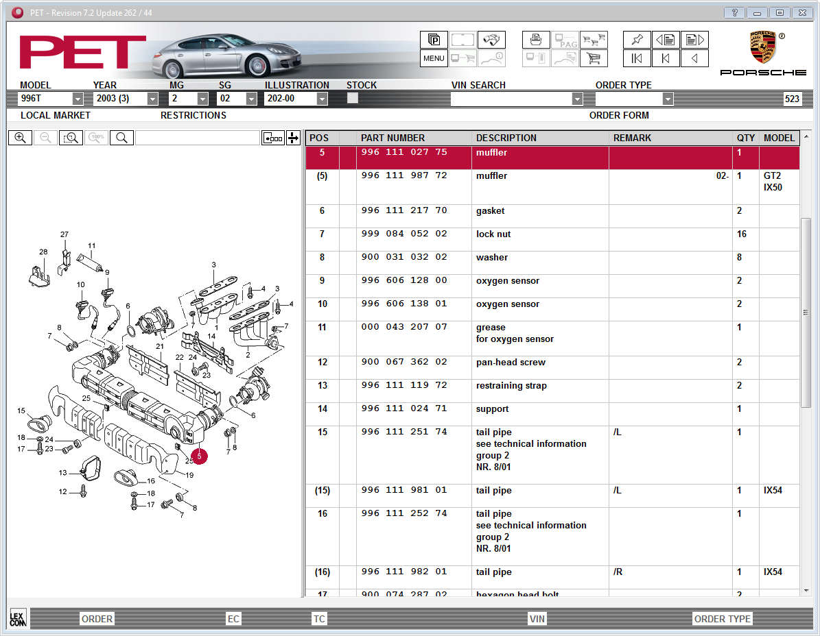

There is nothing in the parts list that signifies the GT2 muffler is used for X50. The GT2 muffler is a different part number but I do not know the differences.
Oh... and my 1 year old price list shows it at $2869.42 not the $7000 he mentions. If it came off a GT2 then the part number should be 996 111 987 72.

Well, 996 111 987 76 is not a valid part number in my Sept 2004 parts list. As I said the muffler listed for the GT2 only says GT2 next to it - no mention of X50. I've got a friend with an 2004 X50 I'll see if I can get him to crawl under the car and read the part number.
Well, my friends X50 TT exhaust has 996 111 987 76 written on it (thanks Joe). So the GT2 uses 996 111 987 72 and a standard TT uses 996 111 027 75. I still don't know the difference between them or why the 76 is not in the parts list. Unless the 72 has been upgraded to the 76?
Perhaps the next parts list will show the change?
I just checked my 2003 996 X50 and it reads 996 111 987 74. So I guess it would be obvious to at least conclude that the Std TT has a different exhaust than the GT2/X50 and a number of revisions have quite possibly been made to the GT2/X50 exhaust since 02 (e.g., 72, 74, 76). They seem to be related to the years/versions vs. whether or not GT2 or X50.
