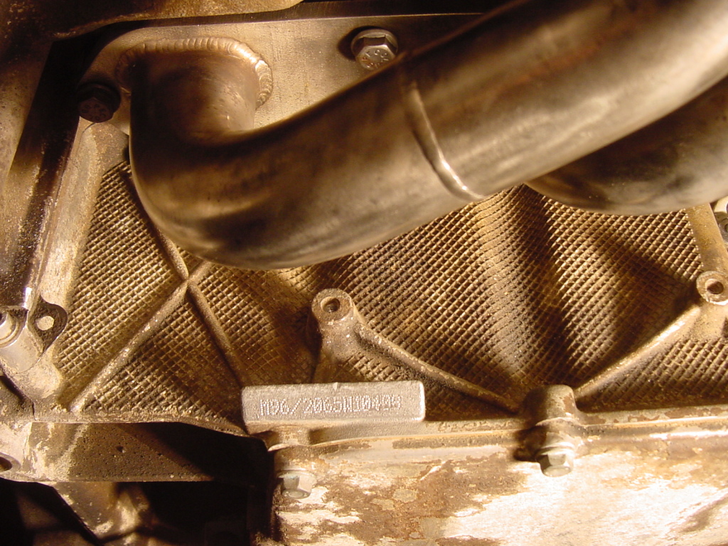

Here is a photo of a Boxster engine serial number. It does not appear to match the above scheme for numbering, unless I am reading it wrong:

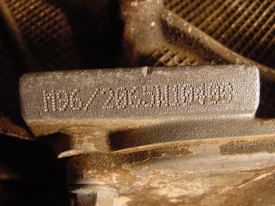

Maurice - the W in your photo is Model Year W - 1998. The engine type is a M96/20.
Richard:
Thanks for the clarification. The engine in the photo is indeed from a 1998 Boxster.
Does the "5" after the "6" mean it is the "fifth" version of the M96/20 engine?
Regards, Maurice.

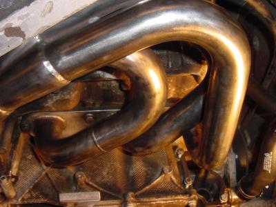

The engine number is stamped onto a flat protrusion located just above where the oil pan meets the bottom of the block, all the way at the rear corner of the oil pan, on the passenger side (on a Boxster). Keep in mind that on a 911, the engine is oriented 180 degrees around.
Here are two photos which should help to orient you. (Note that the thermostat has been removed in this photo and that if you don't have headers, the exhaust manifold will look different, and a lot "flatter").
In this photo, the opening onto which the thermostat is normally mounted is at the bottom right, and the engine number is all the way at the bottom of the photo, near the left edge of the photo:
Here is a closer view of the raised boss onto which the engine number is stamped:
