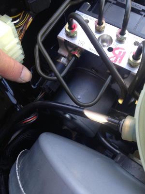

I have had this problem. Durametric throws faullts for stop light switch, so I replace the switch on the pedal. This didn't fix it, so I took the car to a specialist who advised it was the pressure sensor / switch on the ABS PSM hydraulic pump. It is a seperate part to the pump, but the shop seemed unable to locate a replacement part, other than buying the whole pump for many $$.
I've been unable to find a part number for this switch, can anyone advise if it is possible to buy it seperately?

From what I can find, that pump is only available as a complete assembly, and retails for around $3K:
ABS PUMP ASSY - 2001 Porsche 911 (996355955BX) List Price: $3,428.24
  • You Save: $586.74 (17% off)
  • Sale Price: $2,841.50
  • Core Charge: $772.84
