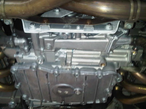

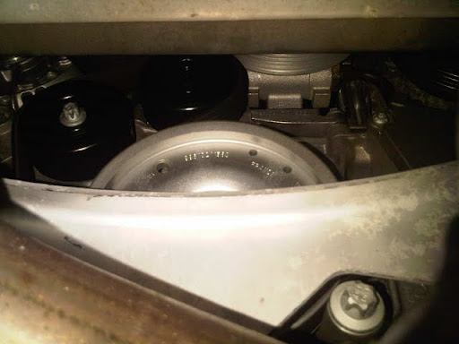

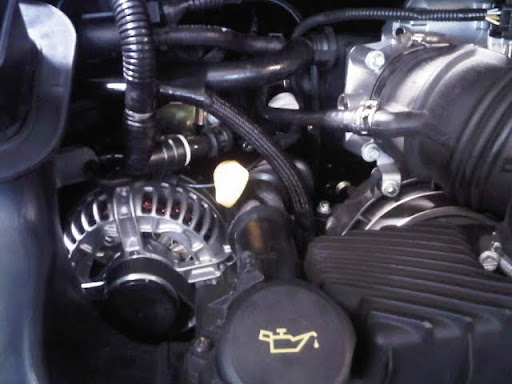

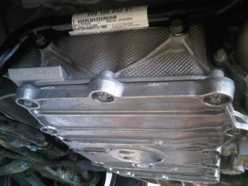

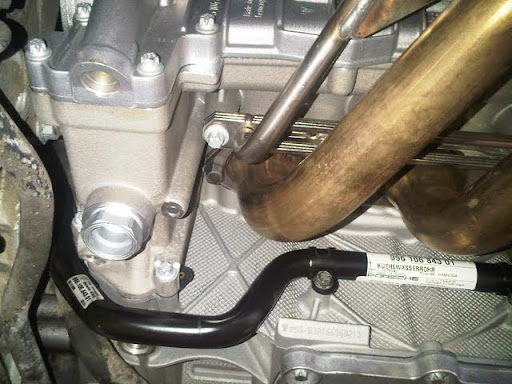

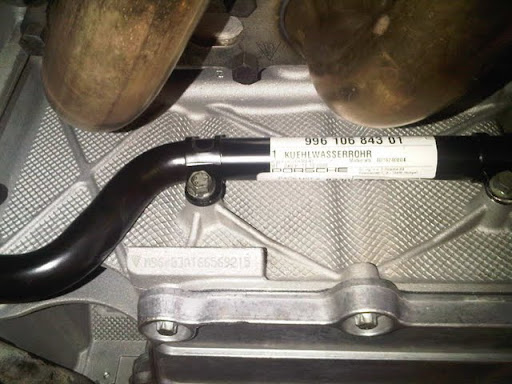

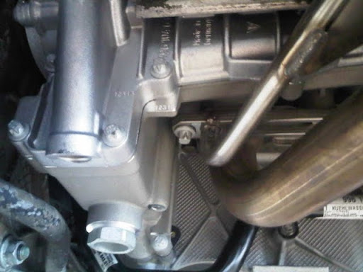

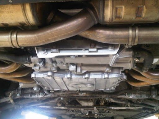

2002 C4 Cab 3.6
Dealer is in Boston MA.
Parts and labor was $25K.
Warranty covered most of it.

I purchased an exclusionary warranty from Fidelity Warranty Services - which is ONLY sold through dealers.
The conditions with which Fidelity would warranty my car was that it had to have a PPI done by the Porsche dealer selling the Warranty (which for me was Danbury Porsche) so that they could weed out 'pre-existing conditions'. And the cut off when I purchased it was 50K miles and 2002.
It was $4K for a 3 yr warranty.
The new engine comes with another 2 year 100K mile warranty.
The only problem with after market warranty is that they reserve the right to replace with "Like Kind Quality" which means I learned that they had the right to replace my engine with a used engine from salvage as long as it was the same year or newer engine with same or less miles as when mine when kaput.
I paid the difference for a new engine from Porsche.
