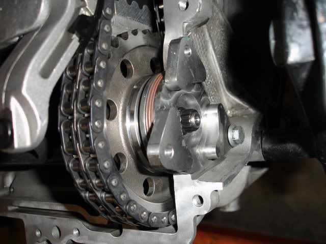

The teeth are about 3.5 mm tall. On three chain engines they can jump more easily. 5 chain engines it is much less likely. It is still worth removing the cam caps to verify the timing marks regardless.
Yes, if the timing is off, you can have piston/valve contact and possible meltdown.

I really need to caution you on attempting to rotate the engine with the IMS bearing out; you are tap dancing in a mine field by doing this. If the engine has not jumped time yet, it most likely will when you attempt to rotate it…………..
Thanks, JFP I appreciate you taking the time to answer my questions. So, how "tall" are the teeth on the sprockets and how easy is it for them to jump? We are pretty sure timing was good when we started to disassemble, and other than the releasing of the tensioners there hasn't been any movement.
It's not my call, but my friend wants to install the new bearing. I will insist we check the marks on the cams before we fire it up. I deduce from what you say that if the timing is off there can/will be piston/valve contact.

The M96/97 is an "interference motor", meaning the valves will contact the pistons if the cam timing is off. This is what you are dealing with at the IMS bearing sprocket:
Oh no, I realize that. I have NO intention of moving it a millimeter until the bearing AND the tensioners are back in. Just trying to evaluate my odds of still being in time at this point, and how to proceed once we get a bearing back in there. Thanks.

The outer race is out.
Plan is to put the new bearing in, reinstall the tensioners, then pull the plugs and turn the crankshaft, by hand, two revolutions.
Question: If there was interference would I be able to move through it by hand? (Plugs out....)

Yes, the “interference” may have already "clearanced" itself by bending the valves out of the way, which is why we (and others) always bore scope one of these before doing anything..................
If the cams are in, or very near time, the engine should rotate (clockwise looking at the lower pulley); if you encounter any resistance, I'd stop right there.
