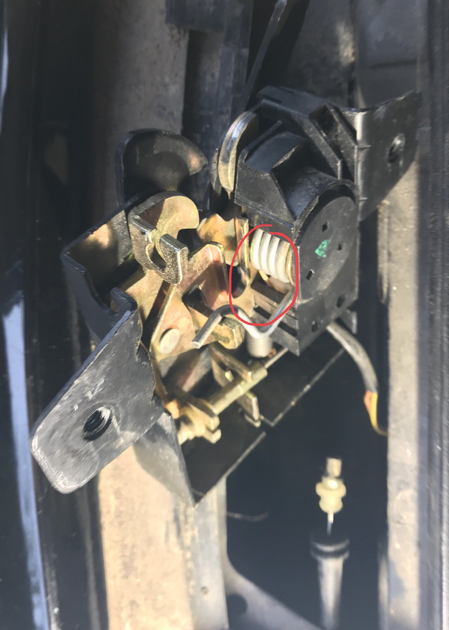

I was working on the front trunk latch and switch today, on my 986. The light had not been coming on when the lid was opened.
Once I was in there, I found a small pine needle lodged in the microswitch.  My dear dad used to park it outside under the trees often. ?
Pulled it out with forceps, cleaned everything out and shot the switch with Deoxit.  All is well. Thanks for all of your info on that topic. ????
 Happy new year to all of you.
