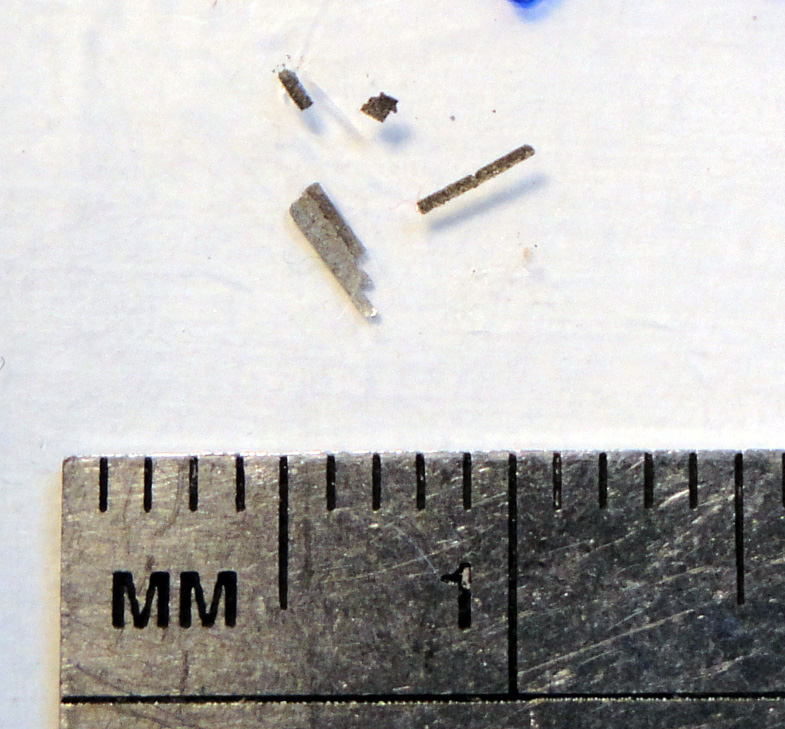

I found 3 pieces of ferrous metal in my oil filter
This is the first time I examined my oil filter and found 3 small pieces of metallic shavings in my filter. If I had to guess, I would say they are about .003 in. thick X 1/32 in.
Can this be the IMS bearing? Should I be concerned?

There are a multitude of potential ferrous sources in these engines, but I would pull the sum cover and also check the cam deviation values as well.
I checked the cam deviation values. Both are steady at 0 degrees.
With that being the situation, most likely it is not the IMS bearing. To find the source, you are going to need to do some digging. Have you pulled the sump cover off yet?

I just changed the oil today and I was going to drive a few hundred miles, then pull the filter and inspect again.

Has the source of these metal particles been determined?
I have the similar ones now myself.  3 or 4 pieces.  Very thin and brittle, and magnetic.  One broke when I was getting it into the baggy.
wrljet did you find out what these were, just oil changed mine and found similar ferrous particles....worried! :(
I pulled the bottom of the sump off and found nothing else similar in there.  Just some bits of plastic, presumeably chain guide rails.
(and some RTV sealant)
I talked to Jake Raby on the phone about it. What he had to say sounded good to me, so I spent money to ship them the car and have it inspected.  He suggested the metal chips might be the iron plating coming off a piston, but couldn't be sure.
They gave me a quote for a bunch of work, more than the car was/is worth.  So I had them just button it back up and ship it back.
I switched to the DT40 oil, per his suggestion.
No more similar metal has been found in the filter since then (it's been 2 years, but I haven't run it too much).
I did find the tiniest spec of aluminum.
The engine taps quite a bit, which I believe is sticky lifters, but nothing has gotten worse.... yet
My car is MY2003 with 23K. I am the orginal owner.
Hi, appreciate it was some time ago now but did you determine the source of this in the end?
