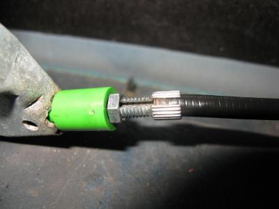

The flexing shows you that the inner metal cable is traveling but not having the desired effect of dropping the window the normal 3/8 to 1/2 inch. To rectify the situation you have to either replace the window regulator or install a device to take up the slack. Taking up the slack produces the desired effect where as soon as the electric motor turns the cable acts on the window, causing the drop. If you repair it, you will notice that the cables don't flex nearly as much, showing only a very slight flexing movement.
I repaired my window regulator for exactly $1.00 by installing a bicycle brake adjuster in line at the base of the front window regulator leg, next to/on top of the small green plastic bushing. I can't take credit for that repair as a poster on 986forum came up with the rather ingenious (and cost effective :lightbulb: ) solution.

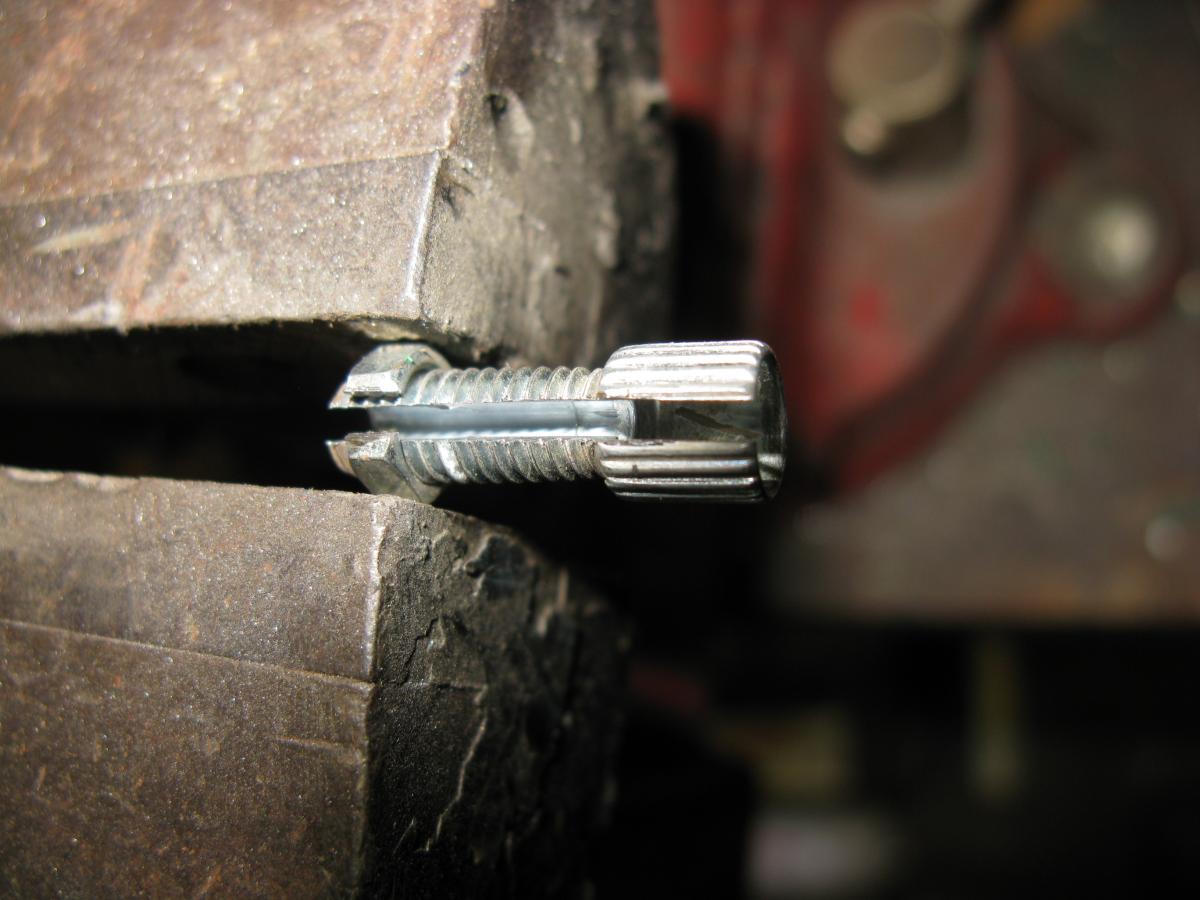

Here is what the $1.00 fix looks like, at the base of the front leg of the window regulator:
post-6627-0-63890100-1381457598_thumb.jp
If you slice the bicycle brake adjuster and its nut longitudinally as you see in the photo, you can just slip it in place over the cable without having to disassemble anything. The sliced part of the nut is 180 degrees opposed to the slice on the adjuster tube (so you can't see it in this photo).
