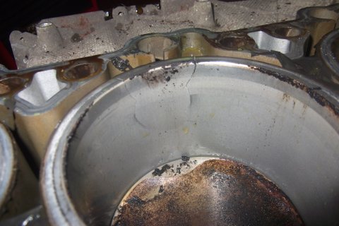

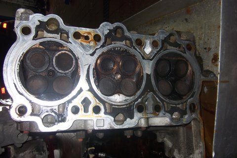

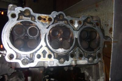

A few Pictures from the inside of my engine. You can see the cracked cyllinder linning.
So far so good. I need a bit of advice on what else I should change in a prioritised order, now I am giving the engine a complete overhaul?
regards
John
LN Nickies liners, the LN triple ceramic bearing IMS upgrade (or the IMS solution if it is a single row engine), LN chrome moly oil pump drive, LN spin oil filter adaptor, ARP bolts (cylinder head, rod, and crank carrier), oil pump, water pump, billet tensioner paddles, new tensioners, AOS. I'd also look at replacing the cam followers with later design units that have less tendency to plug up. go through the heads carefully while they are off, replace anything that shows signs of wear (springs, retainers, etc.), fresh valve job.

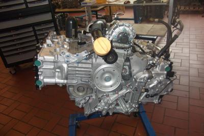

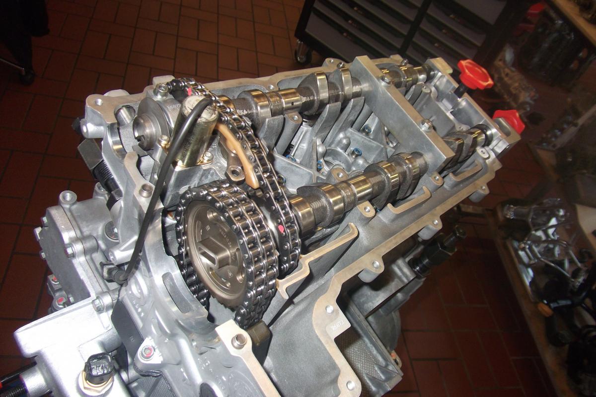

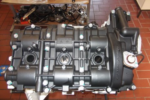

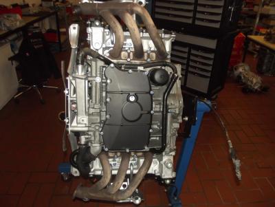

My engine went bust dec 30th and now I got my car back from Pomotec in Germany. Flew down early tueday morning and drove the car the 750km back to Denmark. It had a complete owerhaul and support systems like AOS, waterpump, Clutch, IMS etc has been changed. The bill was massive, but they gave me a 2 year warrenty on the engine with out a limit on kilometers driven, which I can extend after the 2 years to a 4 year warrenty for a small amount. The cyllinder block and liners was done by Capricorn in the UK. The coating is Nicasil.
Not to open a oil discussion, but the Pomotec guys are very much in favor of using Motul 300v 15w50 Competition. Their basic advice for a long life is very much i line with what is discussed here and goes like this:
  • Use a good oil and check it often and change it every 10.000 km
  • Check your water level often
  • Do not drive the car beyound the rev limit
  • Any warnings lights and you should stop the car at once.
They still have 40 cars at the workshop and one of the mechanics told me that he was going on his first vacation in 4 years this summer.
Bottom line. I am so happy to have my car back, and next week it will get a new top, so it better behave for many years now :drive:
