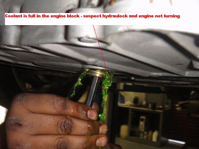

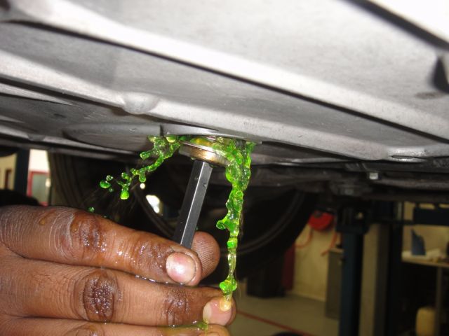

while driving with the Porsche club, and without no temperature rise, i heard an explosion in the engine bay, the car stalled and the whole dashboard lit up.

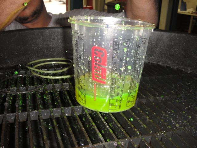

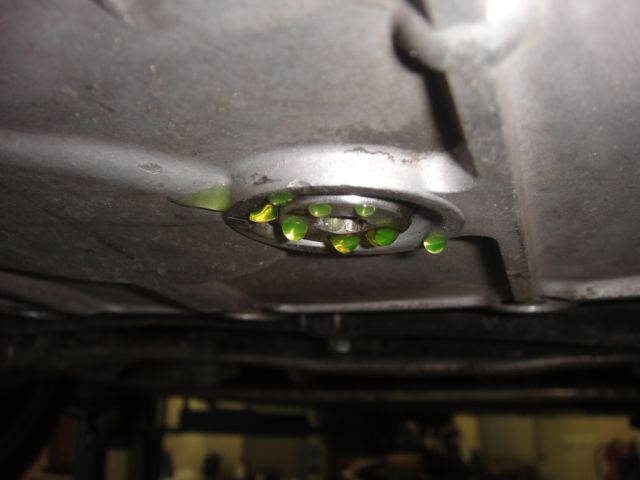

when i opened the engine bay, coolant was all over the place... photos from the independent workshop show that the oil reservoir is filled with coolant... Hydrolock is suspected with all possible scenarios being gloomy...
would appreciate your input on previous similar experiences... could it be only a failed AOS and not a cracked head or engine block??
the workshop will charge me around 1,300$ for investigating the problem, which will not be charged if i decide to go ahead with a top end rebuild or whatever the diagnosis is...
Is it worth investigating now, or i can leave the car parked for a while without any consequences? Is the coolant inside the engine bay terrible in the long run? would it be impossible to clean out if left inside?

Leaving coolant sit in the oil sump will destroy any possible future for this engine, if it even has one, so don't go in that direction. As these engines never blow head gaskets, you probably have either cracked a cylinder liner or a cylinder head. You need to have the problem diagnosed by pulling the spark plugs and dropping a bore scope into each cylinder to see where the engine has failed, or by simply pulling the engine and having it checked out on a stand. Realistically, the engine is going to have to come out anyway, so I would just pull it and find out if it can be salvaged.

Did they boroscope into the spark plug holes.
If that isn't turning over by hand -- might have a cracked cylinder wall.
If you had a hydrolock, the other possibility is a bent rod.
If this happened there is a good chance you can save the engine. It won't be easy to disassemble -- but if done carefully,
you might get away with just replacing the rod.
Of course you'll want to find the source of the hydrolock issue to begin with and replace all bearings as
antifreeze is caustic to softer metals.
