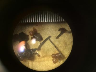

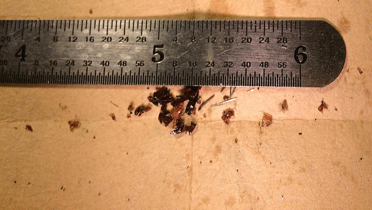

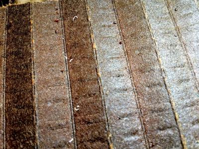

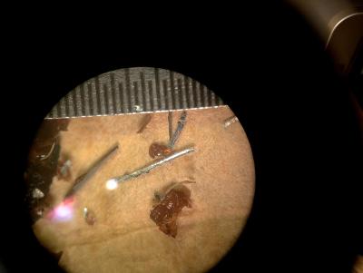

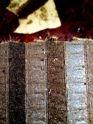

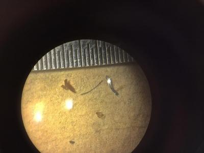

2001 C4 Cab with 60k miles. Bought it 7 months and 6k miles ago. PPI at dealer ---> did new clutch, preventive LN IMS, full service. Runs fine but clutch vibrates/pulsates at idle. Just did oil change and filter. Dissected filter with 6k miles since dealer last did it just after PPI. Never opened a filter before but found a fair amount of debris. Please help diagnose if this is normal or impending doom! Searched and read threads but am unclear if I have a problem. Two kinds of material - brown plastic, some shavings look almost translucent. This was most of the mass by far. I concentrated probably half of what was in the filter and took pics (some under microscope) with 1/64th inch rule. Guessing that is chain tensioner? Is that too much? The second material was metal shavings (no flakes) not one spec of it was ferrous - none of the particles had the slightest interest in a strong neodymium magnet. I am thinking must be aluminum - I can see its clearly shaved/cut particles all in two shapes - only 10 or so 1/8 inch long or shorter needle shaped barely 1/64th wide (more microscope pics with rule). Then there were a couple hundred (maybe 5 to a pleat) very small non-ferrous metal particles/flakes. the metal particles are about 3 thous thick and 10 thous wide and long. I am really hoping someone knowledgeable says this is within ok range. Any insight GREATLY appreciated!! thanks,

As you found no ferrous materials, I would not be overly concerned. It is not unusual to see a bit more debris in the first oil filter after an IMS retrofit. The plastic looking bits are normal chain pad wear, again nothing unusual.
I would suggest moving from the OEM style filter with its known by-pass issues and switching to a "full flow" (read 100% filtration at all times) spin on set up. While it will make checking the filter a bit more difficult, the superior filtration would be highly beneficial. And even if you do not change filter styles, I would change your filter again in about 1K miles to see if this clears up.
