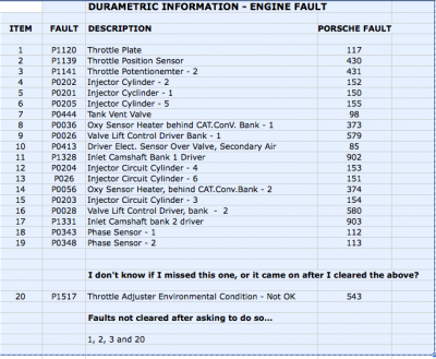

On the same topic, does anyone know if the Porsche PST2 code reader can cancel one code at a time, as opposed to the OBD reader and Durametric program that cancel all the codes at once? To identify which code cancels my faulting water temp gauge I need to know which code it is. None of the codes that are thrown identify the specific code that cancels and restores the water temp gauge.
Thanks in advance for any suggestions...
Post the codes thrown.
Here ya go... if I knew which one of these codes cancels the water temp gauge fault it would be extremely helpful. BTW: the reason I have so many engine faults is that the Porsche engine is gone (LS3 V8 is the replacement) so most of these are N/A, I think. But one or more will cancel the water temp gauge fault. As you can see none of the faults would seem to have anything to do with the water temp, expansion level sensor, or the engine room blower?
Thanks,

If most of the codes are moot anyway, why not just clear everything, see if the temp gauge starts working, and what codes resurface.
That is exactly what happens, I clear the codes, the temp gauge comes back online, until it faults again with the same codes that I had previously erased. There doesn't seem to be anyway to narrow the codes down, it's all or nothing. I've got a call into the lead tech at the San Antonio Porsche dealer to see if their PST2 code reader will cancel one code at a time. I doubt that it will...

I'm afraid you are going to find most system dump them all at one time.
Sadly I'm sure you're right... I'll have to figure something else out to stop the water temp faulting...
