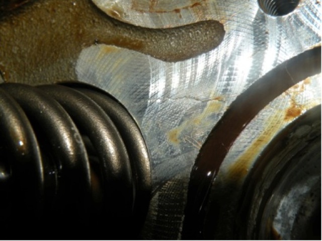

PS: if I knew how to post pictures, I would post the pic Jake sent of my cracked head.
Kim, click on the "more reply options" button and then you will clearly see an option to attach pictures.  Please do, as these are always great to add to the discussion.
