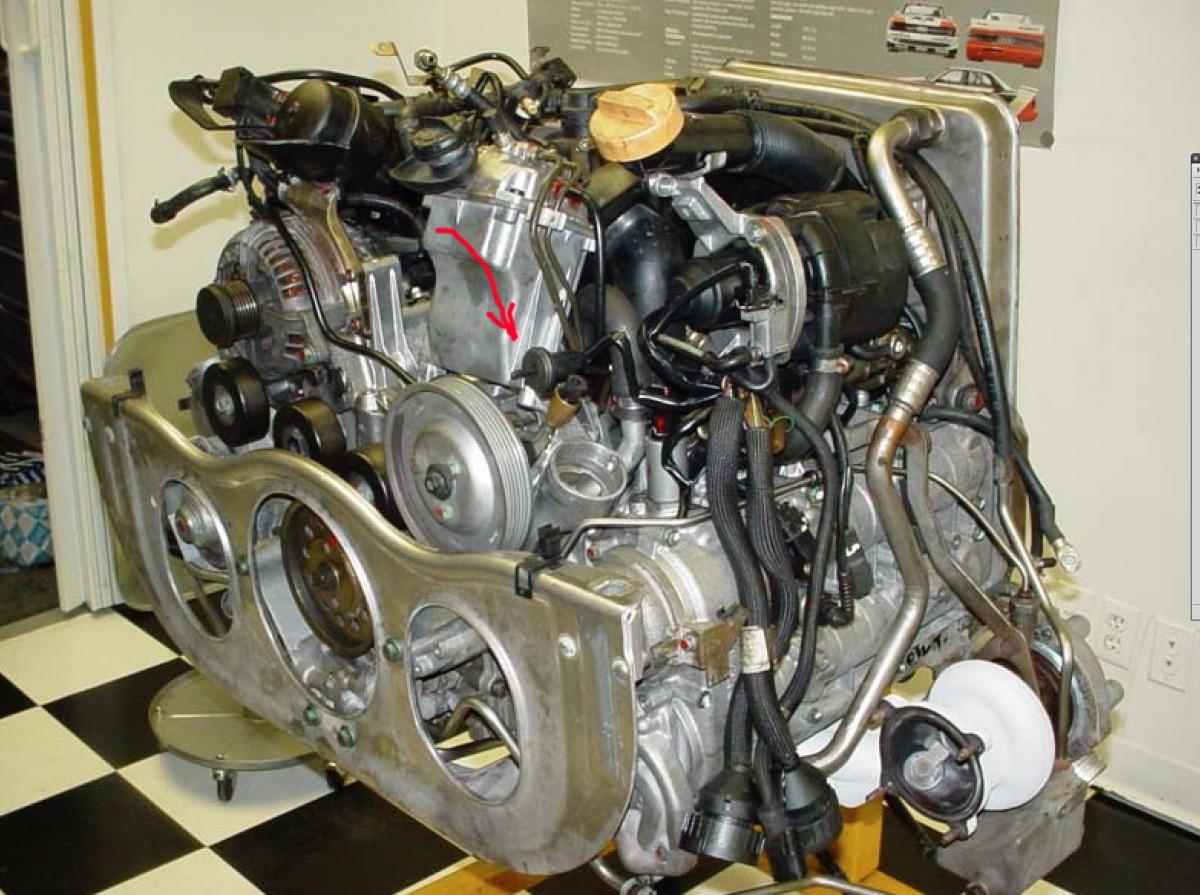

Can anyone help identify the Engine Compartment Fan Temp Sensor Location on the Twin Turbo?
It must be a little more hidden than on the NA cars.
Thanks.
Right side of the engine bay, behind the recirculation fan, near the oil fill cap.
