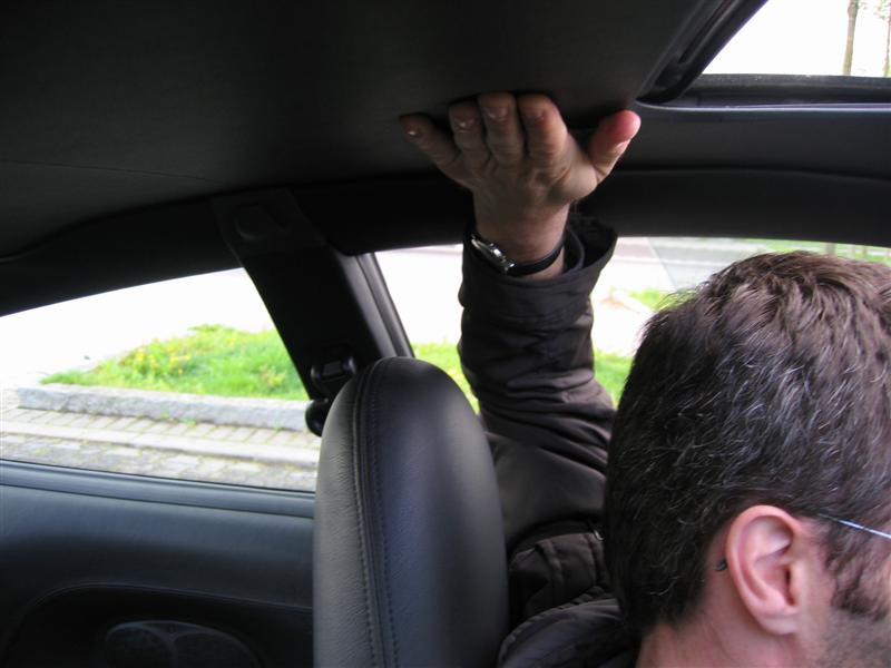

Hi,
I do have ticking, clicking noise in my roof that seems to come from right above my head. When I press firmly on the point shown in the picture the noise stops. Same thing when I do it on the passenger side. I've had the lining off two times now and using the TSB didn't really help since somehow what I find up there doesn't resemble the drawings in the TSB. Or maybe it's my limited imagination. At least I don't have any reenforcement ribs that could touch the roof. (Although the sound is exactly like they were) Almost every part that could cause noises was covered with felt tapes by now but that didn't help either. This is really driving me nuts: I now where to put my hand to make the noise stop but everytime I look at it with the lining off I only find the reenforcement bar that runs from left to right. This thing is really stiff so I can't see how it could possibly cause the ticking. But somehow it does..

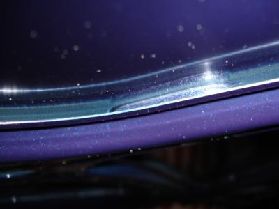

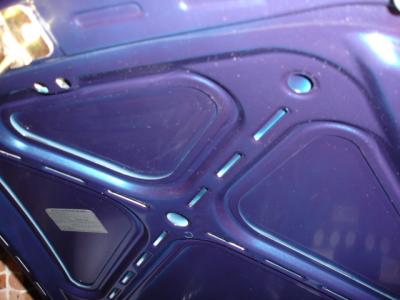

I dont think it was the sunroof that the mechanic was refering to, he said there are bracing sections under the roof and these sections are epoxyed. Not having seen it with the lining out I can only go by his description.
My guess is that it would be similar to the bracing sections under the hood shown in the attached photo.
If you look at the second photo you can see there are small rubber or plastic sections sandwiched between the two sheets of metal. I think these are the pieces that are epoxyed. When the epoxy cracks you get the ticking or cracking noise when the body flexes slightly.
If that is the source of the noise I have no idea how he managed to re epoxy them but whatever he did fixed the noise.

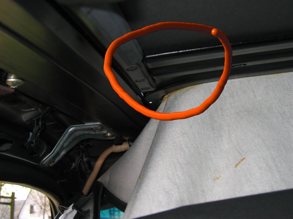

I've added a photo off the area shown in my first post up here with the lining off. As I said the roof is quiet as soon as I put my hand on the circled area. Only slight pressure is needed.
Meanwhile I've come to think it must be the tilting mechanism itself which is located right above the bar shown in the pic. This would make sense since only a few millimeter tilt of the roof is neede to silence the **** thing.
