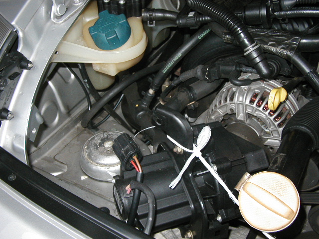

Start by removing the air filter/metering unit. Two clips hold the Air Fuel Meter cable in place. Disconnect AFM connector and set aside.Remove single bolt holding AF assembly (13mm) and tilt unit back to remove. Set aside.
Remove 2 bolts and 1 nut (10mm) holding air pump. One nut holds the Coolant Reservoir. Set aside. I used some string to pull it away from CR.

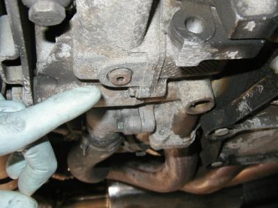

Drain antifreeze by means of drain plug at the bottom of engine. Drain just enough to empty CR, then a little more. I used an aluminum turkey tray to hold antifreeze and reuse.

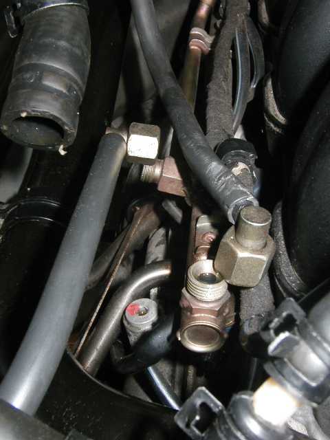

Loosen 3 spring clamps holding hoses to CR. There are two fuel lines that will prevent you from removing the tank from the engine compartment. Loosen (17 & 19mm) them and tuck away (see picture). Disconnect tank sensor. In my car, it seems like it was leaking... (see picture)
Slide tank towards engine and maneuver tank out. Be careful with other hoses and electrical connectors.

1) Agree with the poster that recommended REMOVING the air pump instead of pushing it aside. -- just makes it easier to get the tank in and out. NOTE: the connector on that airpump mounts to the airpump body. It SLIDES loose. I pulled out against it (instead of sliding) and the plastic cracked. It didn't break in a way that required replacing, but better to not break the nice mounting point.
