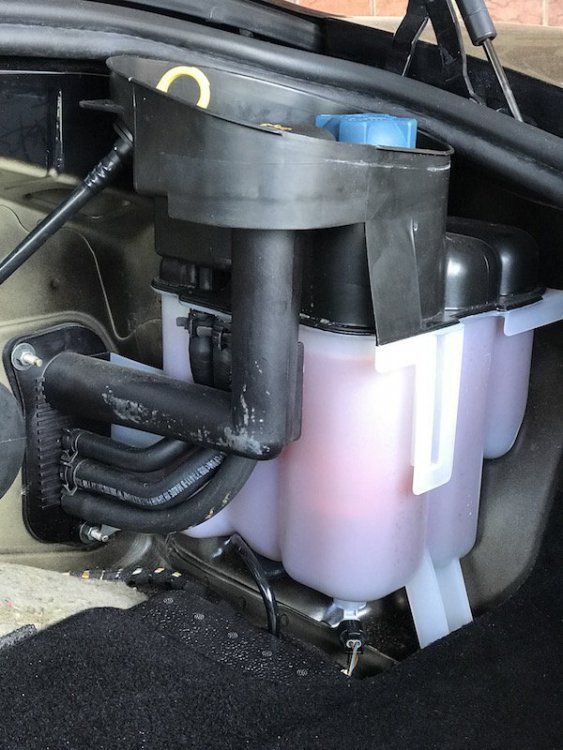

Thanks again crwarren11! Cleaning out the front radiators is something that is on the countdown list of things to be done prior to our PCA Chicago Spring Tour in June. Prevention of catastrophic failure is easy for my brain to cope with, like the IMS. However, everything I've checked on the cooling system is in perfect condition including the coolant fluid (see photo) which matches the appearance of brand new Porsche coolant. It seems a shame to replace any of it, but I will. I placed the order for the water pump and gasket, stat gasket - I ordered the 160 degree stat from LN Engineering, Porsche hose clamps - yes I know some use other types but the originals have been perfect, and the Porsche coolant. I'll pickup everything in a couple days when one of the out-of-stock hose clamps comes in. Yes I'm paying a little more than ordering online which is almost totally offset by not paying for shipping, but I really appreciate their willingness to help me at every turn and taking every opportunity of applying discounts to the max they are allowed. And, they have always supplied the latest version of every part I've purchased, as opposed to many heavily discounted older versions of some parts available online (not Sunset, they have the right stuff). Sunset is my favorite for online and phone orders. I am not replacing the reservoir yet. The water pump seems to me like a good candidate for routine mileage based maintenance. Being at 45,000 miles, and considering the age, and since the thermostat is being replaced, I figure pump and stat get replaced together. But the tank is up top and easy to monitor, so . . . . I read Ahsai's great writeup on getting the last drop of coolant out of the system and will be using that as my guide. Thanks Ahsai!

So I opened up around the coolant reservoir to assess its condition prior to ordering a new one. I was expecting yellow brittle plastic like many photos I've seen posted everywhere, but instead I'm presented with what appears to me to be a reservoir manufactured in mid 2004 (date code) that is in immaculate condition! No yellowing at all. 1. What causes the yellowing? 2. When a reservoir is in condition this good, is it really as much of a concern for failure as one that has obvious signs of aging? Also, there are no signs of seepage so far. I'll be inspecting the bottom of the water pump for "crusty" stuff next chance I get.

Thank you both for your replies! The serpentine belt was replaced on a major service that was done within 2 months of purchasing, which included IMS, RMS, AOS, oil & filter, trans fluid & filter, plugs, air filter, cabin filter. By this time the engine oil and filter had been changed twice since my purchase, once immediately including inspection of filter and then again with the major service because I'm nuts. At the moment I'm on the fence regarding replacing the coolant reservoir. I'll probably do it, but the other side of my brain is saying that I could do it later and wouldn't require much fluid replaced since it's "at the top" of the system. So a question I have is, does draining and refilling the system involve enough stress on the reservoir that more often than not a failure could occur?? If the law of averages favors failure, then I'd have to replace it. Peace of mind is something I preach to others on matters such as this, but I've already replaced the brakes, plugs, and coils last month, now this, and then the Spring Tour isn't really cheap either. Arrgg! I guess I just talked myself into it. What's another $300. I keep telling myself I just won't go out for dinner as much, but that never happens either. See?? This is cheaper than therapy and totally drug free! I'll save a little for now by not replacing the turn signal switch cluster for a while. crwarren11, when you say your car runs cooler with the 160 stat, does it run cooler even after long distance driving? I ask because my car runs in the low 190's at 70mph while on trips to neighboring states, so I wonder if it flows more coolant through it than the 180 stat can do while they are open?
