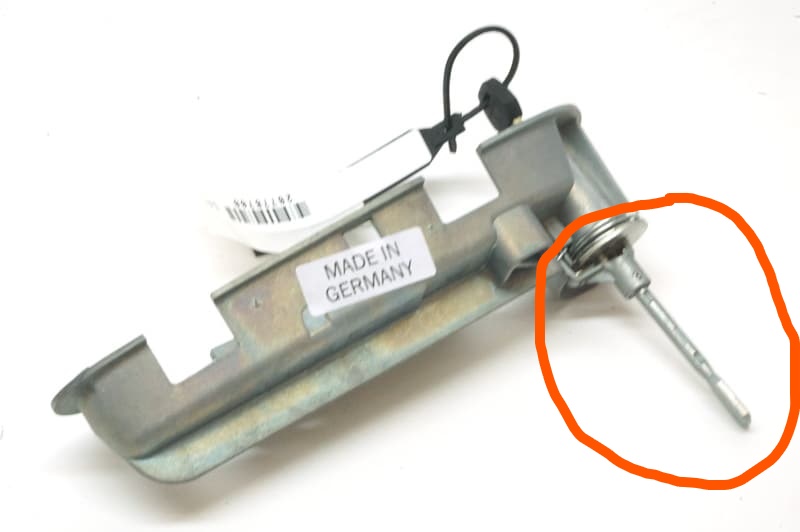

  20. If the key fits in the lock cylinder and you can turn both left and right, but it feels loose, without any resistance than the circled part in the pic. is probably broken or badly replaced after a previous intervention.
