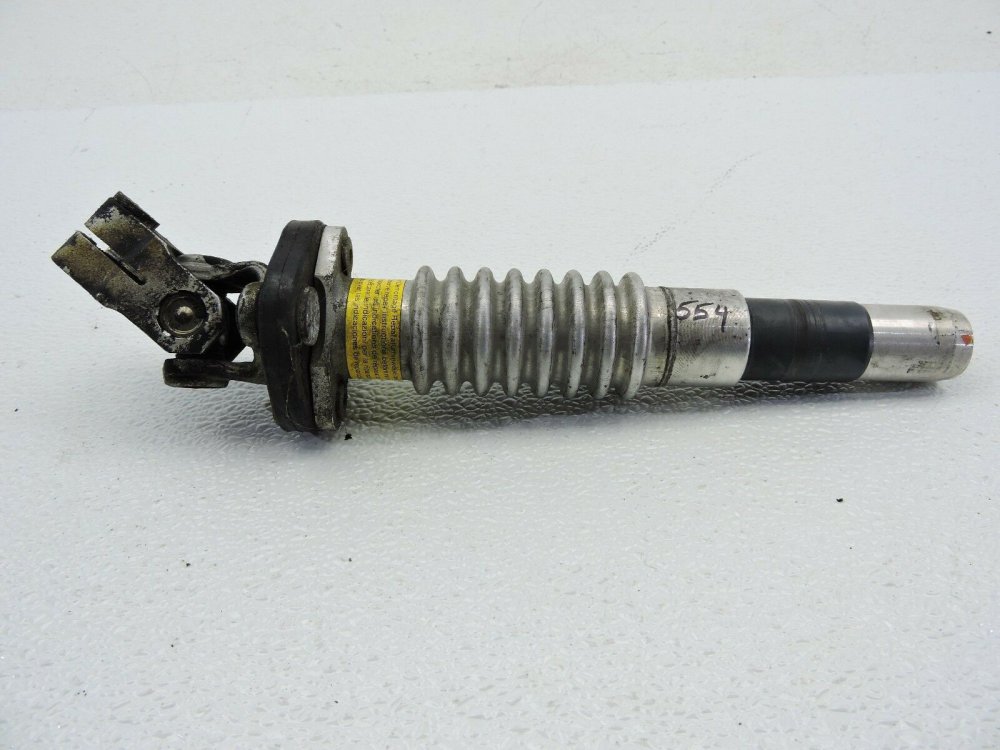

  5. The circled part in your photo above is considered part of the "upper shaft" assembly, which includes the splined shaft that connects to the "lower assembly". Porsche does make the circled u joint available as part number (996-347-023-02) for about $400 "lower shaft assembly" which includes everything down to the u joint that connects to the rack: Installation is flat out a *****, because your need to separate the two segments of the lower shaft assembly, attach the splined shaft and upper u joint to the assembly under the dash, reinstall that, then install the other half from underneath the car onto the splined shaft. And for the life of me, I cannot think of why removing the gas tank could lead to this.

  8. The lower shaft section for a 4WD 996 is 996-347-023-02, retails for around $412 and includes both joints
  9. Here is a photo of the entire column out of the car: The lower section comes out the bottom of the car, the upper section pulls out from inside the car after about half the dash is removed. There are two "universal" joints on the lower section, one right at the rack end, and a second one under the boot. The lower joint uses a pinch bolt to connect to the rack, but working from memory, the upper may be held in by roll pins, but I am not sure on that point. I haven't had one of these apart in a long time. The lower joint is the one that wears the most due to the angle it operates on, and because it is exposed to the elements more than the upper unit.

  12. Hate to be the bearer of more grief, but the steering shaft comes out though the bottom of the car, after you have moved the steering rack you just put back in out of the way. And I have no idea if that lower joint is sold as a part, but the entire assembly is in the neighborhood of $2K 😵
