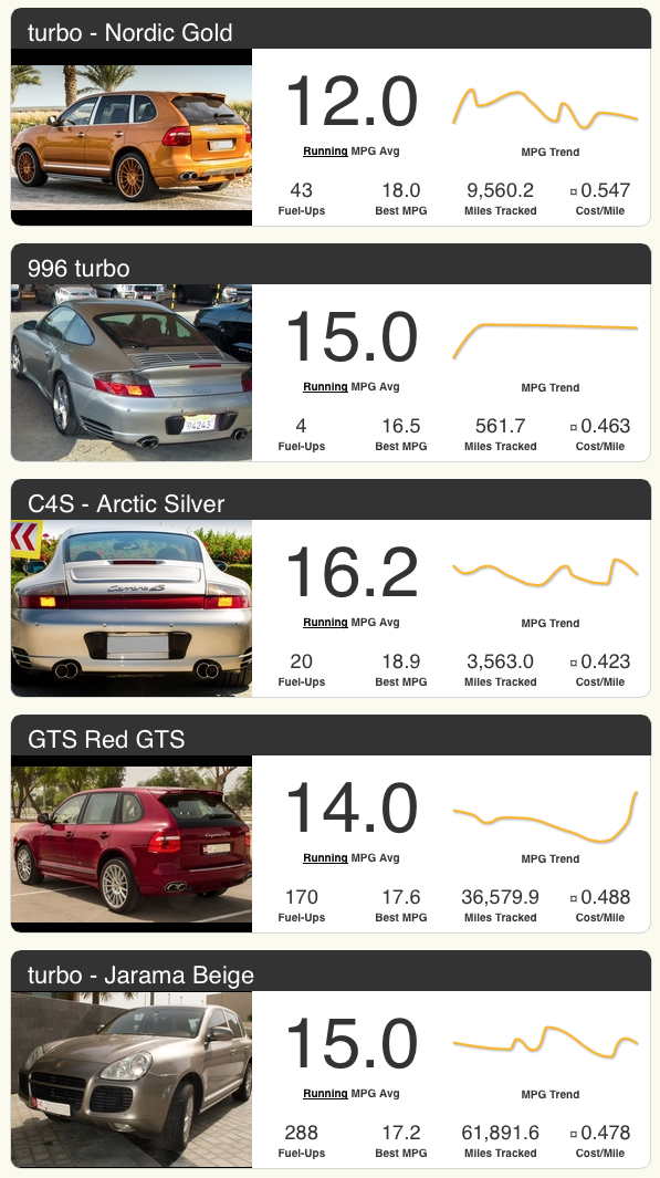

  21. Basic mpg stats for my recent vehicles.
