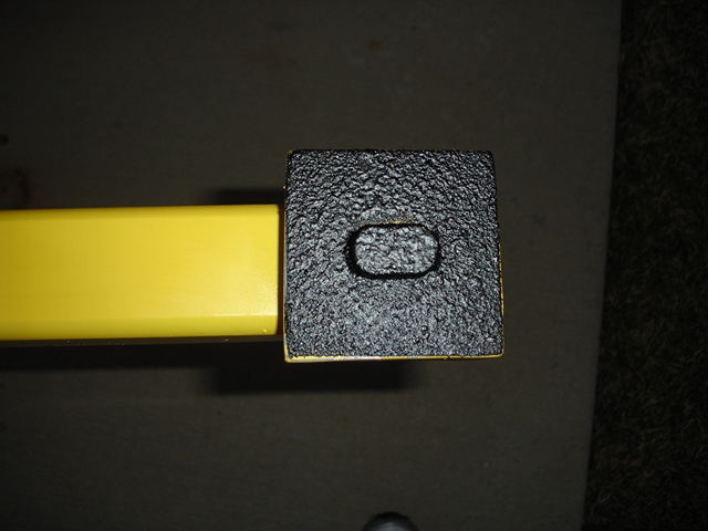

I made these 2x2x1/4 inch square tubular steel bars with jack"pads" that fit my 996 stock jack mounts to the millimeter. The "pads" even have a male receptor to fit snug into the stock Porsche jack pad. The jack "pads" are 3/4 inch thick solid steel. That 3/4 inch dimension is important because it lowers the bar enough to clear any coolant lines or plastics that may be attatched to the undercarriage. One bar fits the front and the other fits the back. Now I can jack and support my car from any point along the bar. I painted them "speed yellow" and finished them with a Porsche decal from ebay.post-35646-1236390525_thumb.jpgpost-35646-1236390544_thumb.jpg post-35646-1236390561_thumb.jpg

Do you mind sharing how, and with what material, you coated the pads (the black material)?
Tim.
Looks like Rhino Liner or some other liner "paint". Looks like he also put the same on the bottom at the jacking points.
Tim.
Tim- the top pad is spray on (rubberized) undercarriage coat, and the bottom is Home Depot grip tape. The top pad would work better with grip tape. From one use the undercarriage coating has already "stripped away". Jim Edited by waterboy

For the jack pad you could use lorry mudflaps.  They come in fairly thick rubber and pieces can be cut to size and glued on with epoxy.
