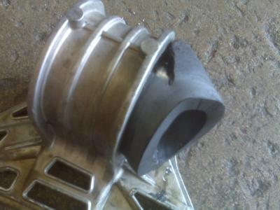

I had a really annoying shudder on hard right turns under power, and traced it to a worn out motor mount. Replaced with an OEM mount (which by the way, is now updated to the 987 part number, as they no longer sell the 986 piece), and the shudder went away. Apparently, the worn motor mount was so deteriorated, it allowed my driveline geometry to be off enough to cause grinding issues. The new mount also got rid of the annoying 3k rpms vibration I used to get when decelerating in that range. My original mount went out at 58k miles.
I have never heard of an engine mount causing the engine to fail. The front engine mount has a high failure rate and has been updated. I think the mount is very easy to change out but I have access to a lift. On a scale of 1-10 I would rate it a 3.

What ever you do don't buy the motor mount from Cheetahonline.com, I installed one of his 11 months ago and 2 weeks ago my car developed this strange noise from the suspension that cost me 1500.00 worth of unneccessary parts and labor, finally after a saga I found out that the mount had failed. It seems the rubber bushing in the cheetahonline mount is too soft and slips out of the mount, this created metal to metal contact and rumbling sounds on turns and bumps. I replaced my rear struts and control arms thinking it was the problem, thanks to curious mechanic friend we were able to pinpoint it sound to the replaced mount. I emailed cheetahonline twice never got any answer. I picked up an OEM mount for $175.00 and had it installed for another $100.00. I took some pictures as they were removing the part....long story short buy the OEM part.
