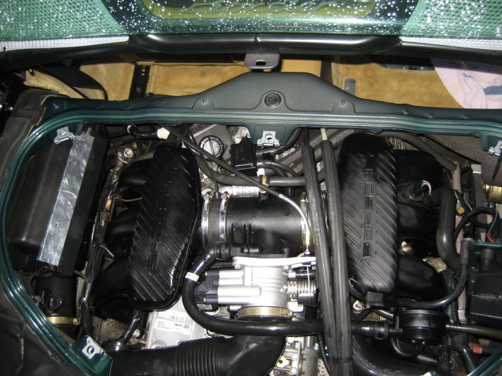

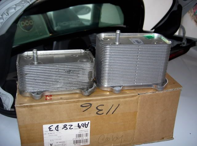

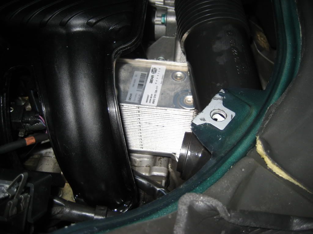

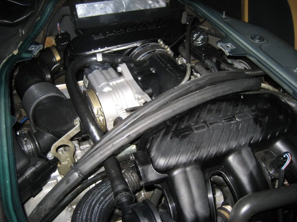

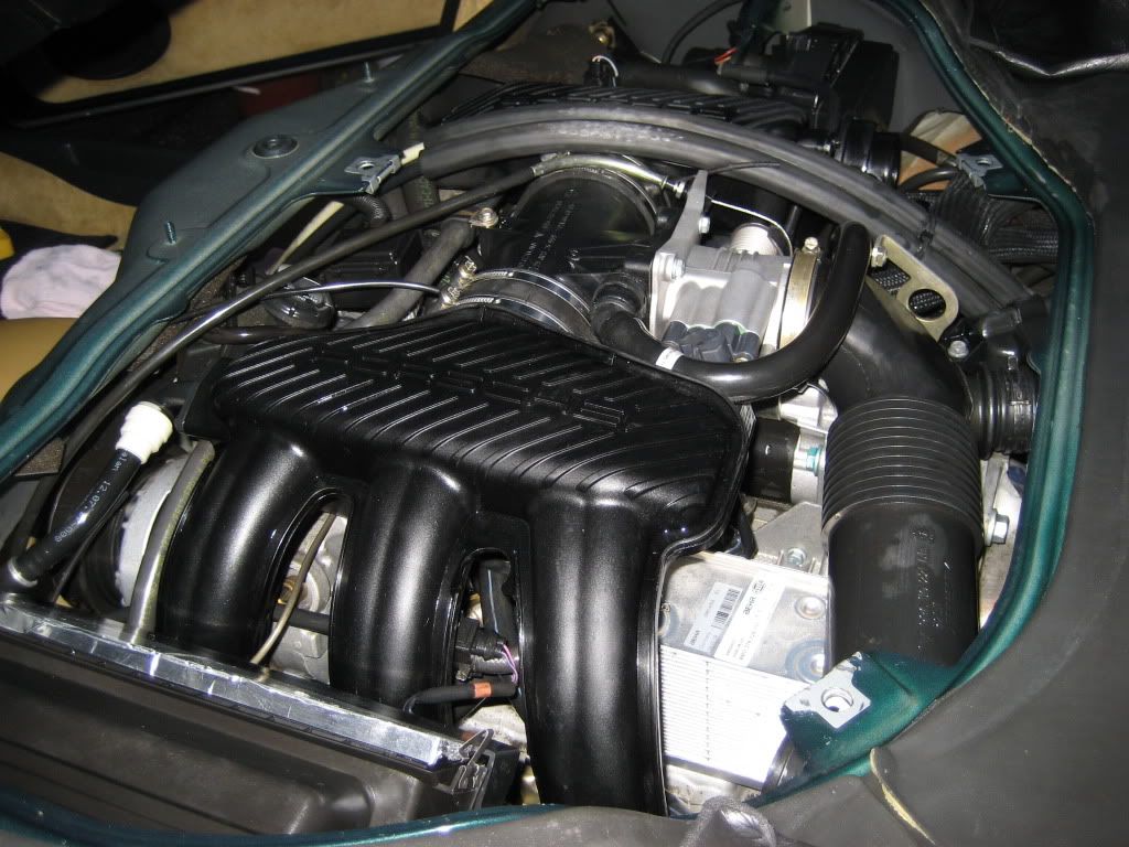

I installed the oil heat exchanger today. It took four O rings.
The green ones are the smaller ones part # 999-707-409-40-M17
The black ones are larger and came in a package of 4 but only 2 were needed, part #999-707-389-40-M100
You can see the difference between the 986 oil heat exchanger and the 986S one.
To install you have to:
Drain water from engine block
I drained my oil and changed the oil filter
Place top in service position
Open engine compartment
Remove air tube from throttle body and air box
Remove J tube
Detach throttle body and place aside (good time to clean it)
Take care in removing vacuum tubes one on each side
Remove oil heat exchanger - 4 torx screws
Replace O rings
Install new 986S oil heat exchanger (tighten to 7lbs torque)
Installation is the reverse of removal
fill radiator
fill oil
Finished installation

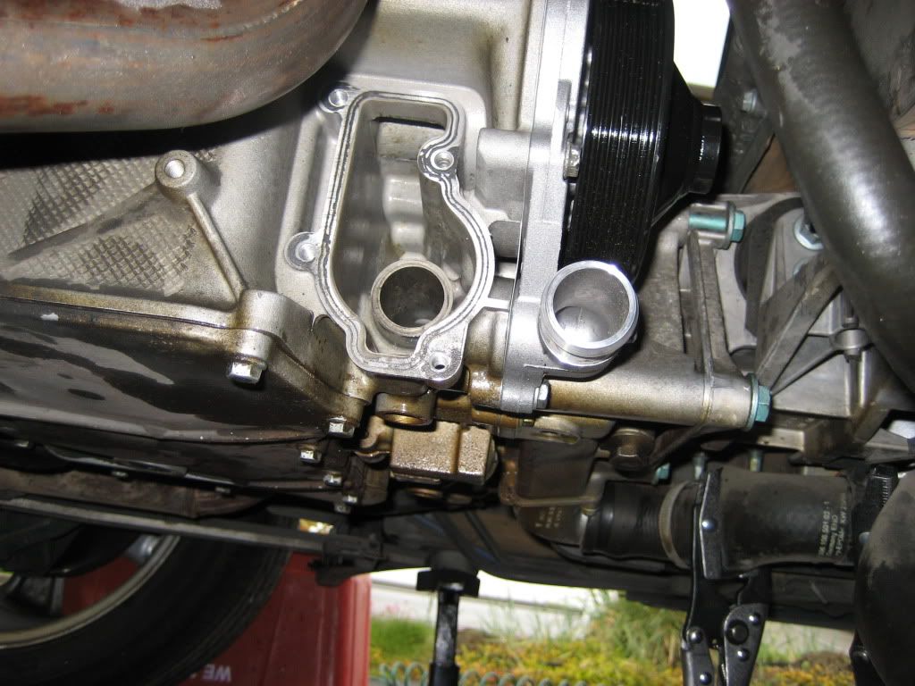

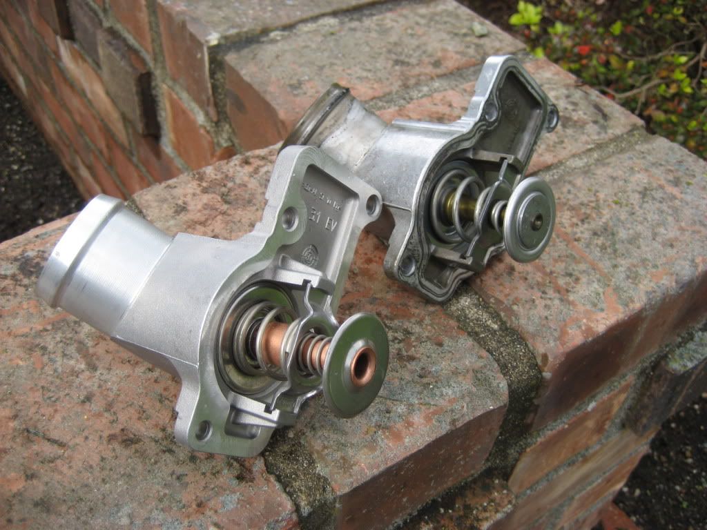

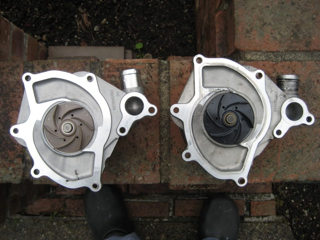

I replaced the water pump and installed the TSTAT 160 today.

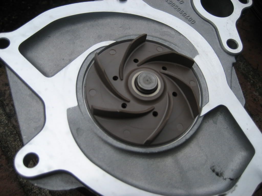

The water pump has seven bolts and two of the bolts are slightly longer than the other five. The bolts at 3 and 10 o'clock are the longer ones. Bolts are tightened to 7 ft-lbs. Photo below shows improved design. Less plastic and more metal in the turbine. I installed the pump from inside the cabin. With 2 bolts removed from underneath. I removed the passenger seat and opened the engine access panel behind the seats. Read Pedro's garage for some additional info and another way to remove the water pump from below the vehicle. I decided not to follow that route. I also replaced the serpintine belt at the same time.
Here is another shot of the new water pump.
I also installed the LN Engineering T160 termostat. Everything inside engine was pristine clear as you can see from the photo below.
There are four bolts and was very easy to install. I also replaced several hoses and clamps. The three I replaced are the main ones that leave the engine; TSTAT hose (1 Y that connects to a couple of smaller hoses) and the two main hoses that route to the radiators up front. Here is a shot of the TSTAT 160 and the OEM one.
I also clean the engine compartment. I followed Orient Express's lead and used a spray bottle with 1/4 Simple Green and 3/4 water. I sprayed then let it soaked. Rinse and sprayed again. Then used a couple of terry cloths and wiped everything reachable downed. Sprayed again and repeat. Just like your hair shampoo.

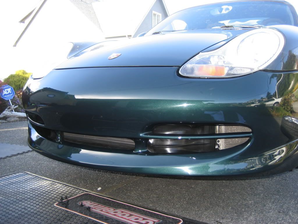

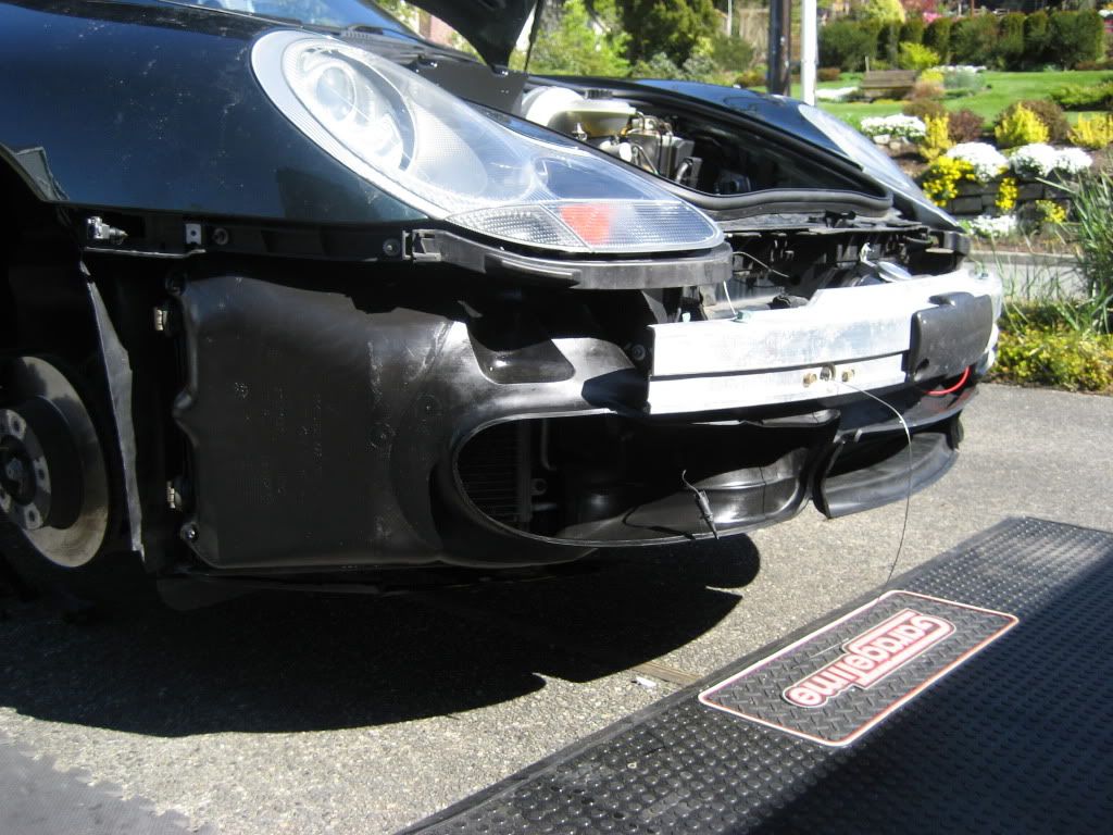

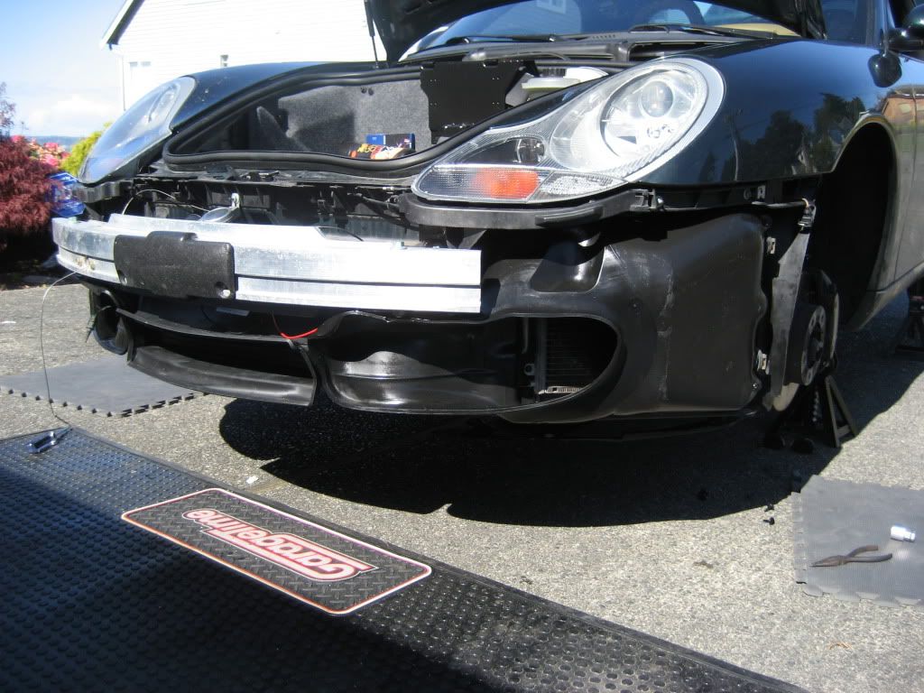

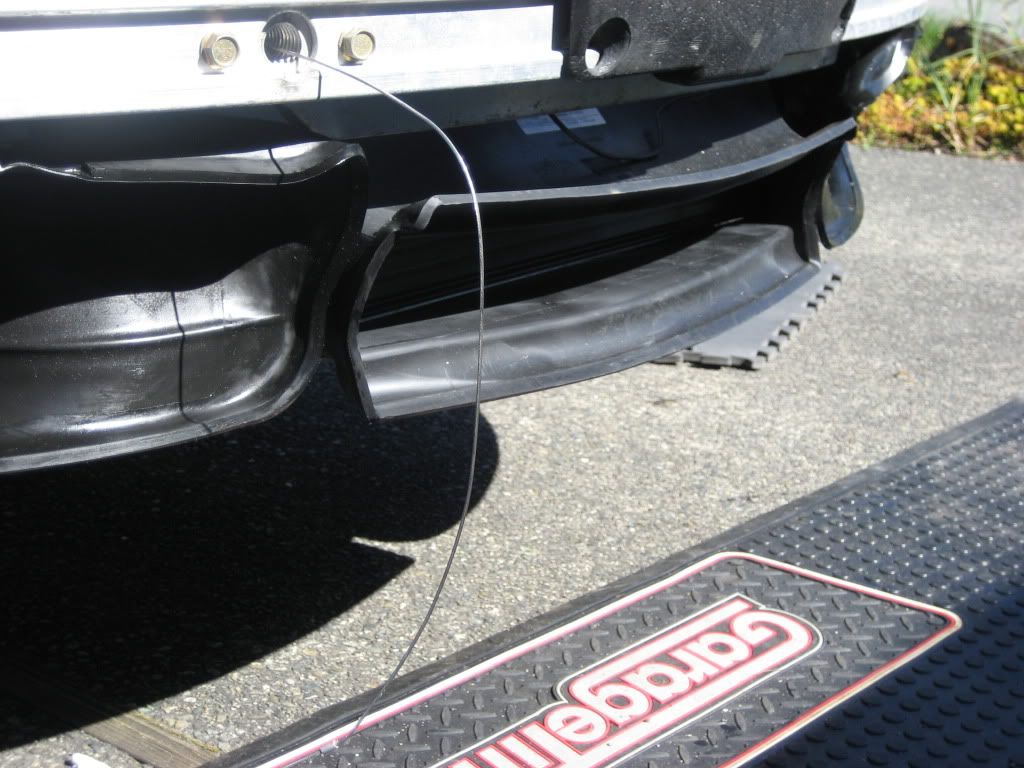

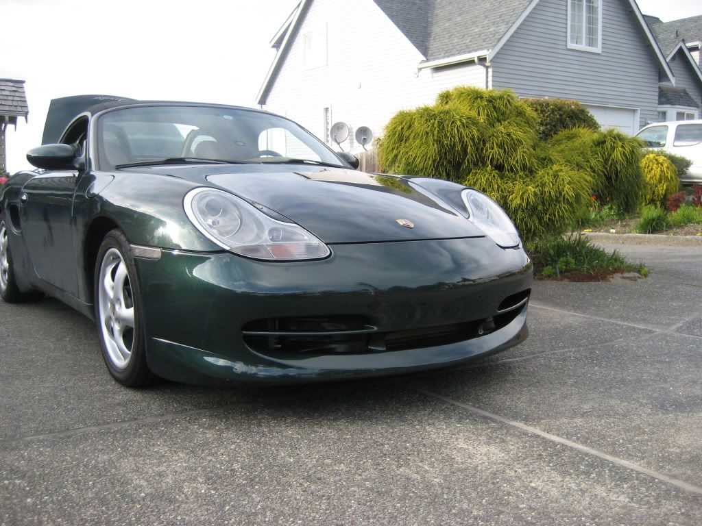

I received the new painted GT3 Bumper back from the paint shop today. I also had them repaint the hood, the little piece that covers the rear spoiler and some speed humps I found on Craigslist over the winter.
I finished installing the third center radiator and cleaned up the side radiators and AC condensors as well as the air scoops and front wheel liners. I checked the system for leaks using the Airlift tool from Uview and refilled the car with 50/50 antifreeze/water mixture.
Here are some photos of the finished center radiator after the installation.
Here is the before picture with the stock OEM bumber.
Here is the new bumper primed but not painted yet
Here are the photos after installing the new bumper
