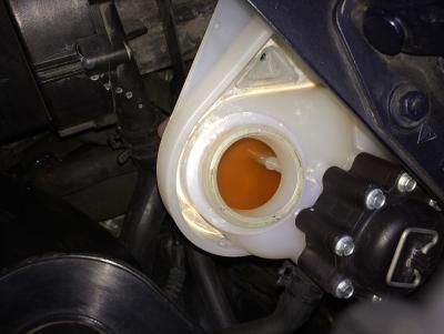

Just had my Tiptronic serviced along with a new water pump. Is the fluid in this picture consistent with the original (or new) Coolant. This is a new (to me) 99 C2 tip and I hadn't noticed the color in the reservoir until yesterday. It doesn't feel like oil when I dip my finger into it.
post-93329-0-34338700-1387419077_thumb.j
