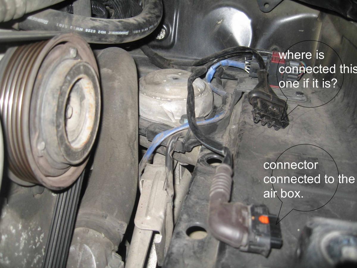

When i removed the air box behind i found a connector which seems to be plug nowhere. here are few picture, am i right or not?????
or do you know where it is plug?
thankspost-69906-0-39043400-1336684223_thumb.j
post-69906-0-64934600-1336684244_thumb.j
post-69906-0-86380700-1336684265_thumb.j
regards
