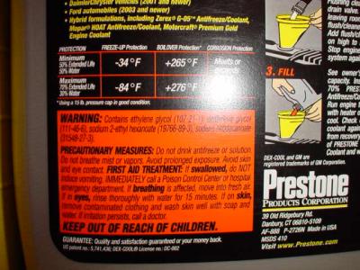

I went to AutoZone and Prestone had what I thought were 2 different coolants, until I looked at the back of the container and compared the list of chemicals. They were identical. I should have opened the one that said 'any color' antifreeze just to see what color it was. This has to be a marketing thing to sell the same product packaged differently.
Go back to you dealer and compare the Porsche/VW/Audi list of chemicals on the back of the container. I know there is a list on the 1 liter black containers sold by Porsche, so I assume VW/Audi coolant has the same list.
Then let us know if the only difference is the color.

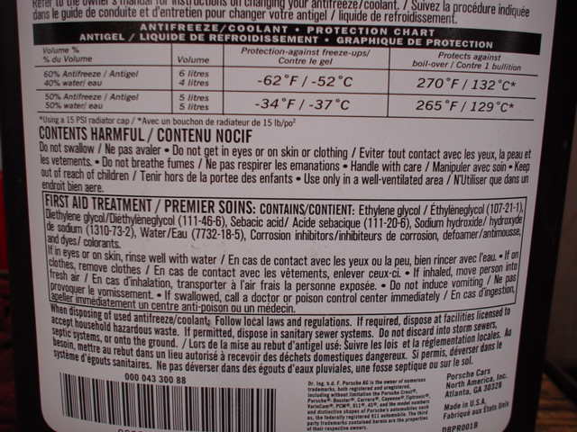

As an aside, several months ago Porsche began selling coolant in 1 gallon containers. When I took this picture in January it was to get a list of the chemicals. I just noticed it says made in USA, if you look at the lower right hand corner.

There is a significant difference in the two Prestone Anit-Freezes you describe. The Yellow, is normal AF which contains Phosphates and is therefore Porsche Incompatible.
The Prestone 5/150 is Phosphate-Free (Substituting Nitrates as the anti-corrosion agents) and therefore is Porsche Compatible.
The chemical comparison you made is from those listed on the WARNING label, not a full Ingredient List. They share many common ingredients, but not all. The difference is quite significant. Hope this helps.

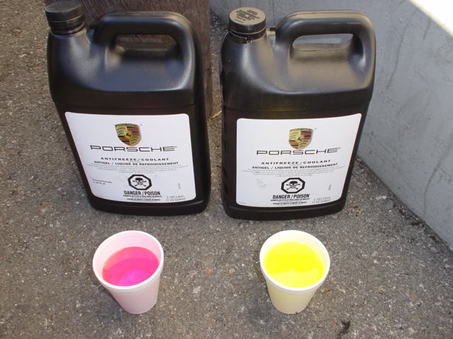

3 years after this thread started I got a chance to sample the Audi pink G 012 flavor.
The second picture is the list of chemicals for the Audi pink. The third is the Porsche pink. The fourth is the Porsche yellow.
Same chemicals used in all 3, but if Jim is correct this may not mean much. I did notice the Audi stuff seemed to taste a bit better....
