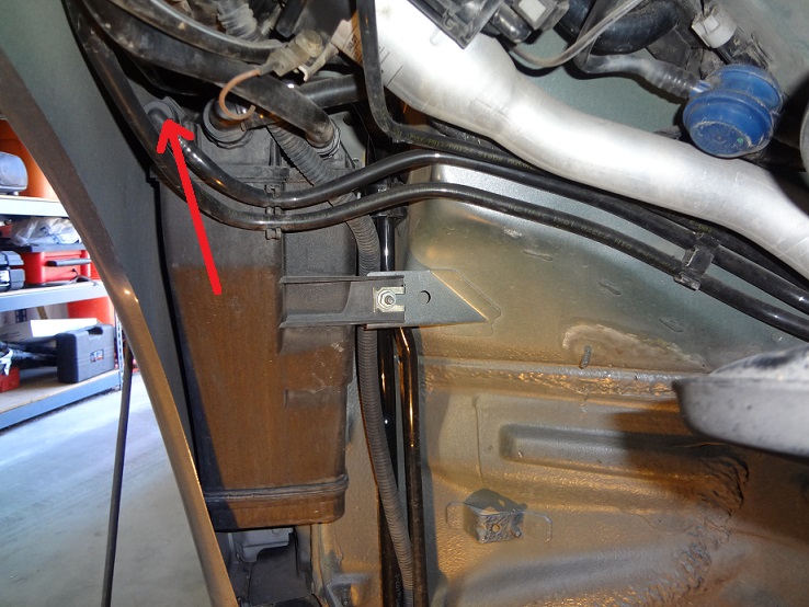

Apparently, one of the hoses was knocked loose as I put the plastic wheel well cover back in place.  The noise is gone, and the new AC hard line is installed and the AC works, and blows at about 42 degrees, and the carbon canister is no longer making that annoying noise.  It was the canister with the three hoses up on the top, and it was the outermost (against the outside fender) hose that had worked loose.

Glad you found the problem... Was it the hose connection identified in the attached photo?
