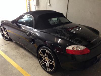

Hi Renntech Experts,
Please pepper my situation with your wisdom...
2001 Boxster S
118,000 Kms
LN ENGINEERING double row bearing installed 1 year ago
last service: 105,000 kms
minor mods e.g. pod filter and cold air intake
A grinding noise started coming from the engine bay this morning while parking the car (warm engine, low rpm)
I turned the car off just after it happened hoping it was nothing
I came back 8 hours later, started the car and the noise was there from the start (recording is from inside)
https://drive.google.com/file/d/0B-lg21ZsNUmnSzFyQmpBd3lqS1k/edit?usp=sharing
The noise changes sometimes (in a bad way), it gets higher pitched for a few rotations then goes back to normal, so maybe its a bearing.
No noticeable change when I turn on the AC
Please share the love if you can
