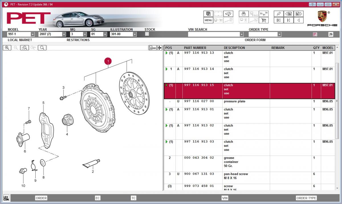

I gave that as only one example of the wide range in prices for the identical parts.  The one that started the thread has a 997.1 so that is what I answered specifically.  And since I have PET 7.3 U366/94 I am quite aware of the part numbers, uses, etc.
So to paraphrase Seinfeld " NO PET FOR YOU!"

I recommend you buy the clutch kit complete, save a couple hundred and have a professional do the job.  As to whether you should do the job yourself.. answer one question.... Would you drop your engine or transmission from your car yourself?  And do you have the complete WSM for the 997?
If you need the Porsche WSM or PET or .. send me a PM
