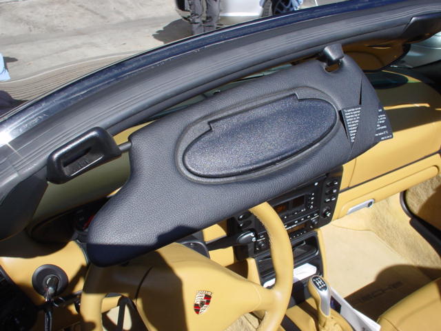

No, you remove two torx bolts on one side and one torx screw on the other (use your fingernail or small screwdriver to lift the plastic cover). Then simply pull the whole visor off. --Brian
Thanks for the great DIY project..I hate those **** stickers, and was planning on covering them until I read you post. My visors on my MY00 Boxster required the following to remove: 2 bolts, and 1 screw
Bolts were removed withT30H, screw removed with T20H...very simply done after "fliping" plastic tab to revel concealed bolt; side closest to rearview mirror. See attached photo. Thanks again for the steps on this project. NVYMED
Thanks for the great article. On my MY00 Boxster it requires the removal of three bolts for each visor. T30, and T20. there is a little tab that flips open, to reveal the concealed bolt. No electrical wires to disconnect. see attached photos. Thanks again for the great article. NVTMED
